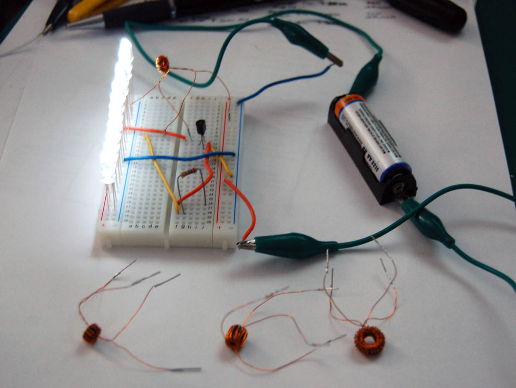

I am attaching a photo of my setup to make the post more interesting, but it is not indicative of the subject matter just to show the scale of things I'm experimenting with now.
