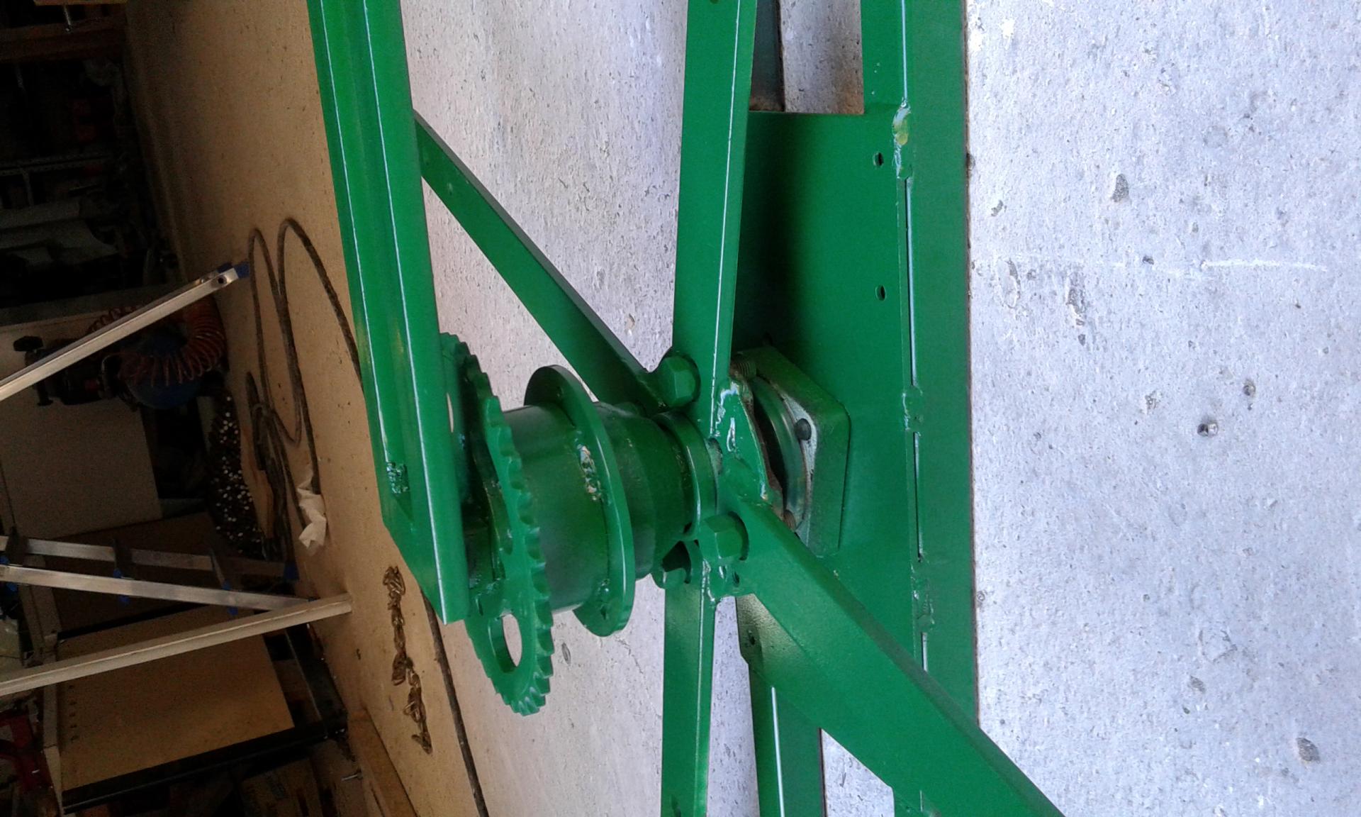

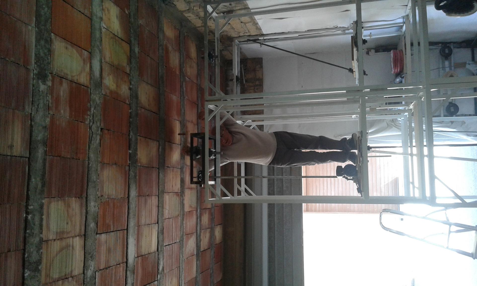

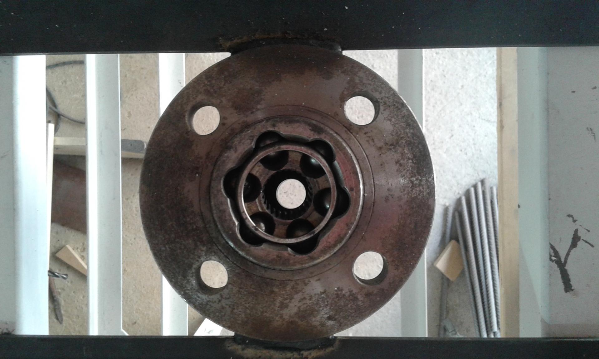

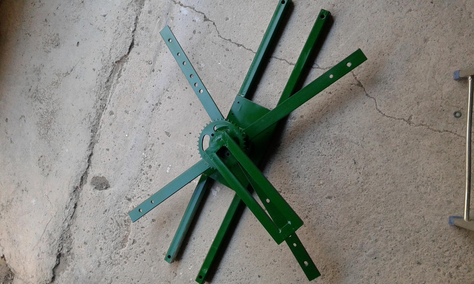

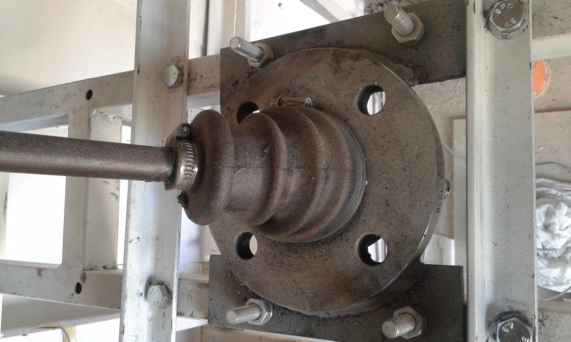

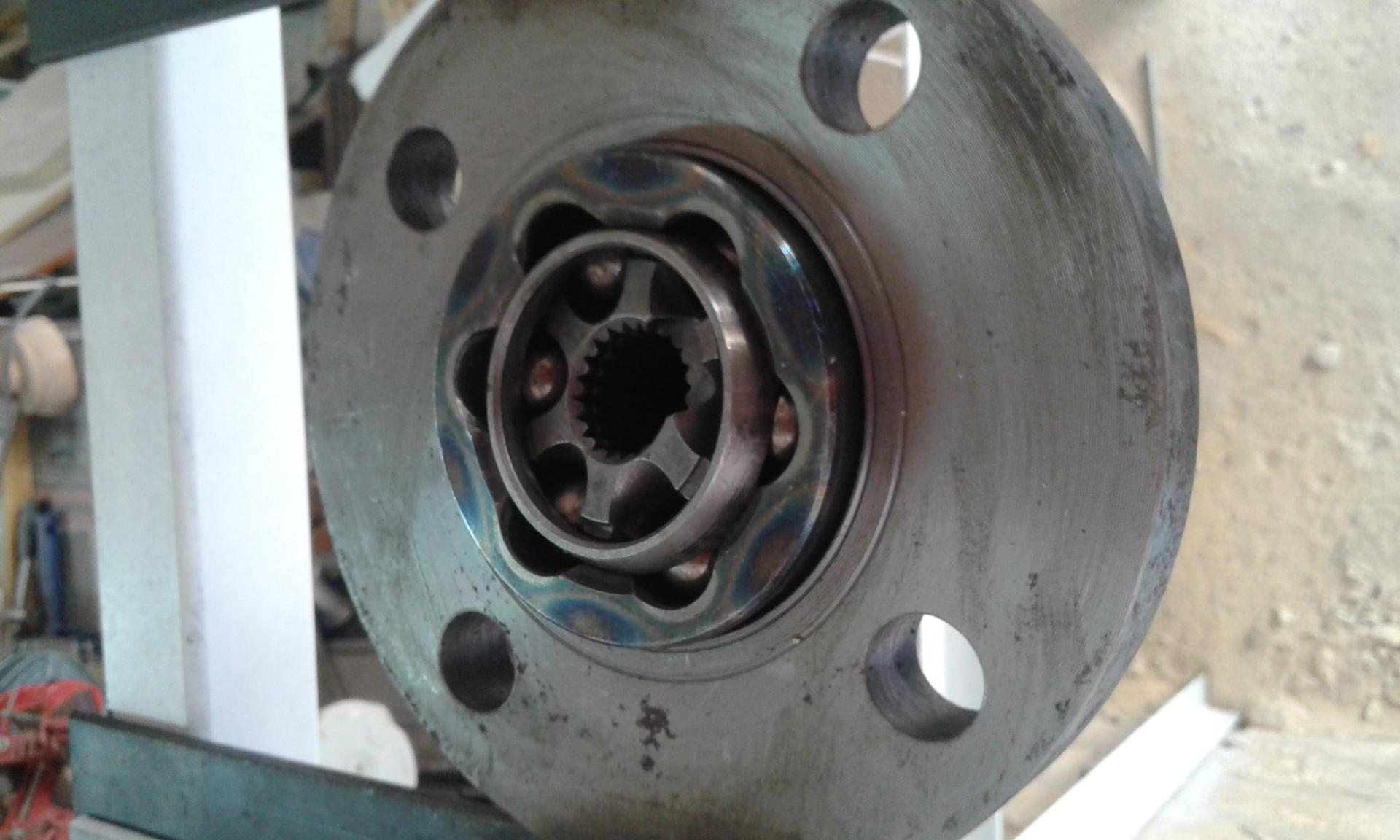

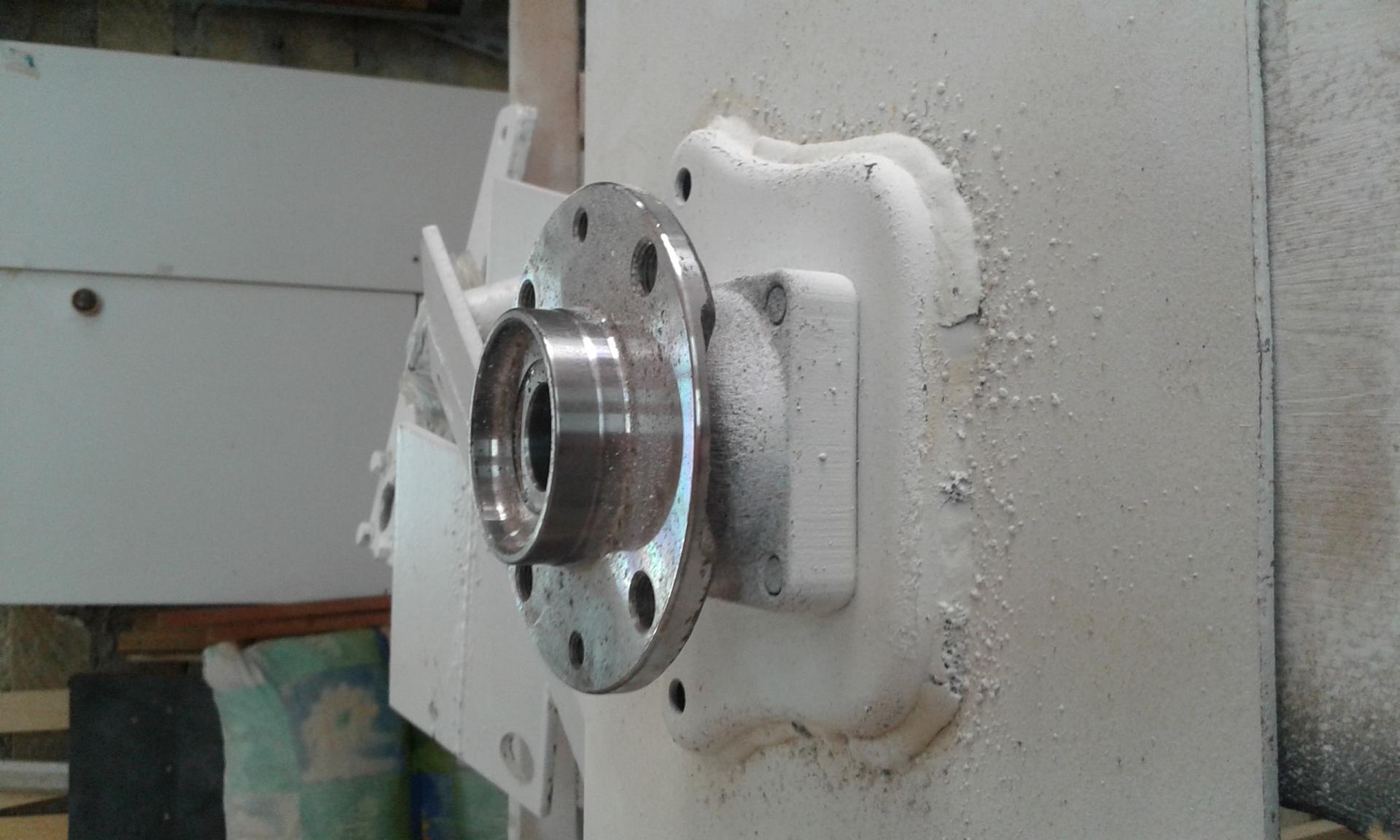

hello, let me introduce my realization of the gimbal installed in my system. I used a constant velocity joint of a small Italian car (Panda). I cut it in two for the length by removing the post of a thousand lines. in this way the remaining piece allows it to be pierced by the axis tilted. I added the rubber dust cover and you're done.
I hope you put to good use.
