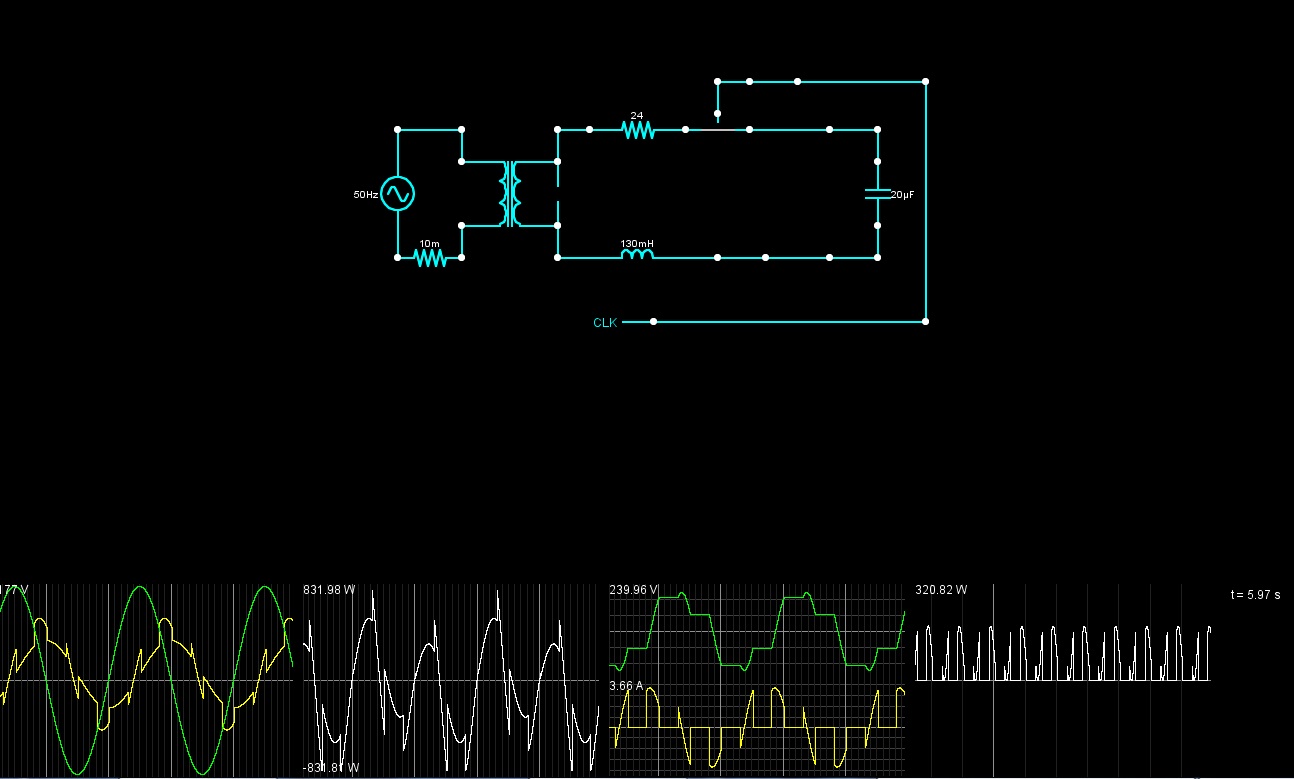

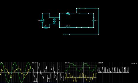

Here is a single cap simulation of one switching scheme which is not ideal and is limited by the simulator clock capabilities but it illustrates that 320W peak power through load, is obtained from 831VA reactive power. So the generator needs to support this reactive power but it is returned to the generator. You still have all the transmission line losses remember.

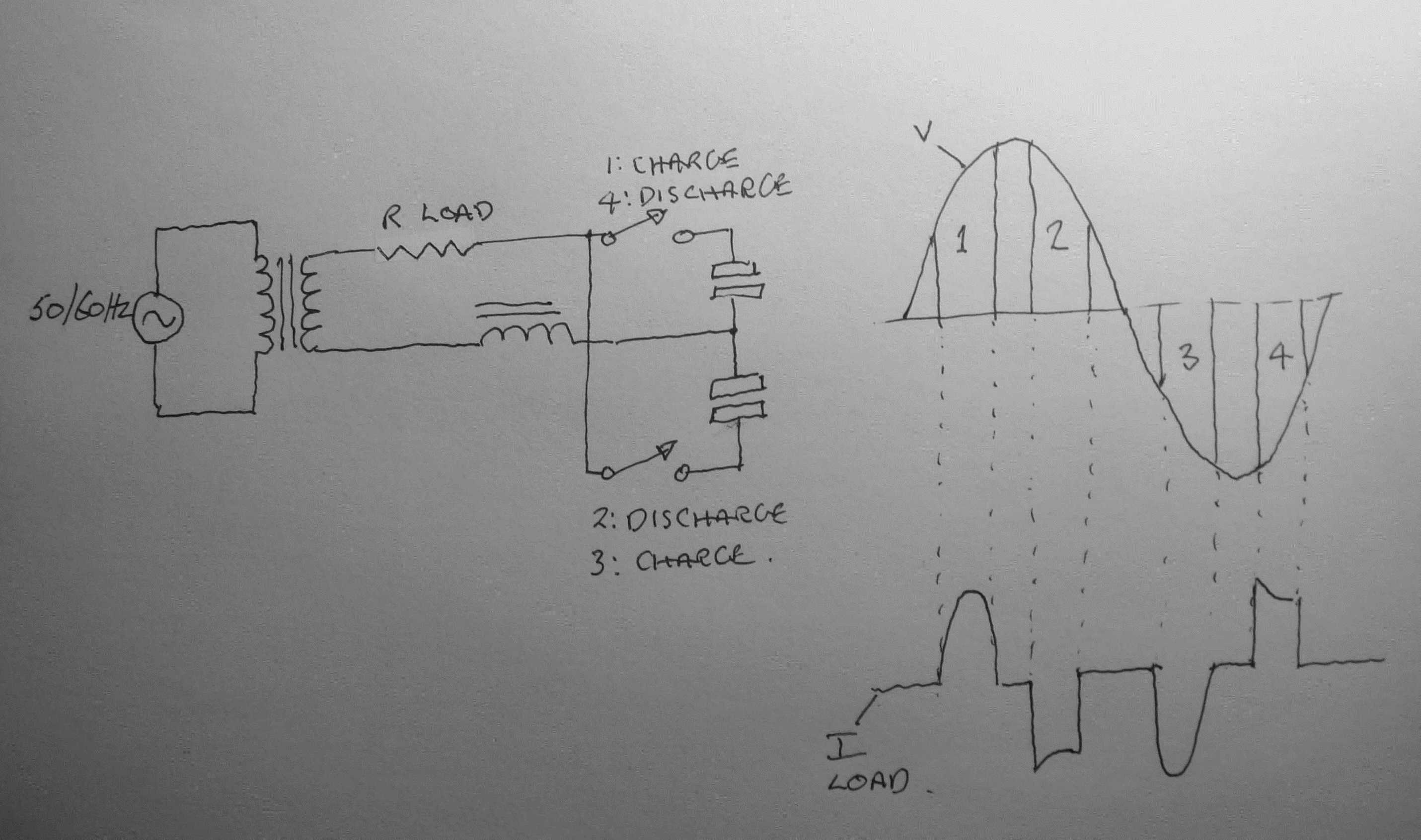

Ideally 2 caps should be used with each cap charging in alternate half cycles and then discharging in the next alternate half cycles. This will give you the waveform shown in the presentation.
You can partially see this in the simulation but not exactly because the falstad simulator doesnt allow timing to be set up for each quadrant (1/4 cycle).
