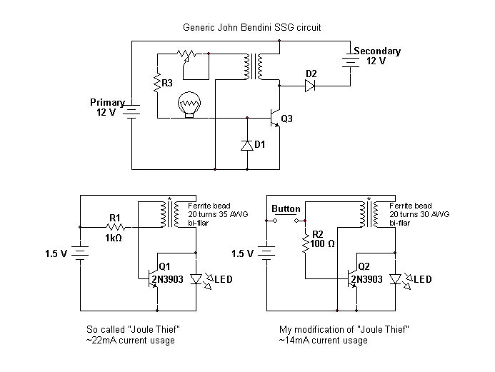

    I was surfing the Web and stumbled upon this simple circuit called "Joule Thief" that lets you run a white LED on 1.5V battery for a long time, by creating high voltage pulses through PWM or back EMF or whatever.
    The circuit layout looked familiar to JB's standard SSG oscillator, minus couple of parts, but never the less. I'm attaching a generic JB circuit, the "Joule Thief" and my modified version. Link to the "Joule Thief is here.
    Since I did not have a whole bead but small bead rings so I got four of them together and wound the feedback transformer. Did not have the 35 AWG so I used 30 AWG. (talk about a hack, eh?)
    In their version I've put together, the circuit uses ~22mA of current with pulses that are 45.40uS long or 21.55KHz.
    With my test battery (1.2V NiMH 2300mAh) that would give me over 100 hours of work time, no?
    After modifying the circuit to resemble JB's SSG, I got it down to ~14mA, with pulses that are 32uS long or 31.25KHz. Not bad I guess with a barely noticeable change in LED illumination (probably 5-8% less).
    Being evil megalomaniac that I am, I hooked 14 LEDs not one to the circuit, without any change in current usage or light illumination.
    So my questions are:
    - how do I make this self-resonate so that it does not need a button shorted to begin the process?
    - also, I always wondered what is the purpose of the Diode across the EB, in JB's SSG circuit?
    - can this be optimized to get even less current consumption
    - what affects the pulse duration/frequency; how do I make them even shorter/faster?
    The diode is there to ensure 1) that no current will flow from the primary battery to the base of the transistor and 2), to ensure that current will only flow through the trigger/base/emitter sections on the current induced as the magnet moves away from the coil. There's a probably a 3), in that it forms a part of the environmental amplification of negative energy formed by the sharp gradient of the field reversal in the coil but I'm no expert on this technology.
      Thanks for the reply Shamus.
      I've tried adding a diode to the Bedinified "Joule Thief" circuit across the Base/Emitter but that wasn't working.
      You said "that no current will flow from the primary battery to the base of the transistor" but I do not see how is that possible when the trigger circuit is only sharing negative pole?
        You are, of course, right. The main thing is to limit the current to fire at the right time (when the magnet moves away). Since the "Joule Thief" doesn't have this feature, the diode probably wouldn't add anything to the circuit. Dunno for sure, I haven't studied self-oscillation in depth as of yet.

          Hi Amigo,
          Awesome that you're looking at other practical applications for these circuits.
          Try putting a resistor directly off the emitter of the transistor. Start smaller and work to higher resistance and see if it gets into oscillation. Not sure if 20 turns will work very well but you can try it.
            Hi Aaron,
            I am not sure what you mean, off of Emitter towards...(Base)?
            I used wrong AWG to begin with, should be using thinner 35 instead of 30 which I think influences the ability to oscillate. Also, my bead is not in one piece so that must have other magnetic effects as well.
            Though do you know what determines the pulse duration/frequency?
            Thanks.
              Hi Amigo, I think the diode is there to protect the transistor from blowing on the negative swing from the feedback coil's back emf. ie when the transistor is not conducting. They usually can only withstand about 6 volts or so of reverse bias (BVbeO)
                Thanks for the post. I did try adding the diode in the Joule Thief circuit mod but then it was not working or not working as intended (don't recall exactly).

                          amigo i did some poking about the internet and found out that more turns = lower freq. less turns = higher freq. and higher resistance has the effect of reducing the supply current (osc only)
                          i found this and and bunch more info here
                          1.5 VOLT WHITE AND UV LED DRIVE CIRCUIT
                          he even used a rusty nail and cat5 wire for an inductor... i love it!
                          on getting your circuit to self oscillate, i really don't know squat about circuit design but could you charge a cap similar to this to get the emitter-base junction to conduct?
                          Simplest_LED_Flasher_Circuit
                          it's probably not possible but i don't know any better so i gotta ask
