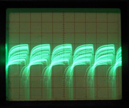

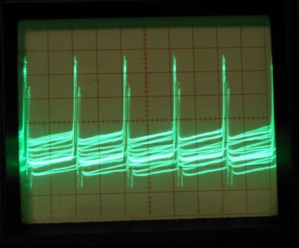

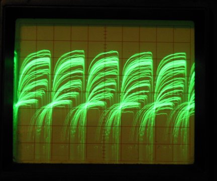

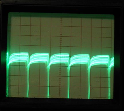

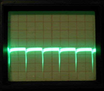

                      Scope shots! Interesting circuit
                      I think this is a very interesting circuit. Initially using a power supply at 1.5 volts I was getting too much noise from the line and had not yet tuned the pots so I went to a couple NiMh batteries that together were reading about 2.6 volts (not fully charged). Initial tuning found a sweet spot on the scope that produced some strong spikes and full of harmonics? I am posting scope shots in order they were taken and successive shots were of different voltage input settings on the scope which show a lot of harmonics I think. All were done with a 10x probe. Adding a ground to the circuit (Tip42 collector) greatly increased size of the spikes. I had to go from 0.2V division to 1 volt division to get roughly the same size spikes just after connecting a ground wire (while on battery power). The 2.6 vots with the 2 x NiMh batteriess yielded 32 volts (Nice!) out as measured no load at the FWBR DC output. After getting the 1 megohm pot tuned in for the above tests I switched to a power supply and adjusted it to about 2.6 volts input. This yielded even larger spikes. It also seemed the circuit was very sensitive to the location of my hands even at several inches away. The TIP42 seemed to be getting quite warm initially after finding a sweet spot so I put a big heat sink on it and it seems to be staying cool enough now.
                      Putting a Fluke multimeter across output of FWBR roughly doubled the size of the spikes on the scope pattern. My fingers were not touching any part of the circuit or the meter probes except on the rubber part. Scope pictures coming shortly. I used my 40Mhz scope rather than the digital 400Mhz scope as it is easier to photograph but it's still a decent scope for the $3 I paid for it at a garage sale
                      Also interesting is that nearly all the scope patterns were showing a negative output except the last one (I think that was when I hooked up the Fluke meter - maybe the leads were acting as an antenna since they are roughly 4 foot long each).

                      • #26
                        Just getting started playing with this. IIRC those output spikes are bigger and stronger than any of the other battery chargers I've built (like the radiant ones from a couple members here and OU). Considering the low input I can certainly see how this would charge batteries good. I've got several to test it on and may see how it does with charging a set of 350 Farad caps in series (6 of them set up like Laserhackers power boost pack). That last scope shot is the one where I put the meter across it. Also once a battery is on it you see positive spikes above the zero line.

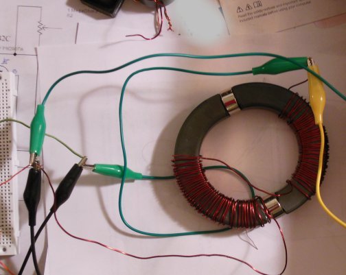

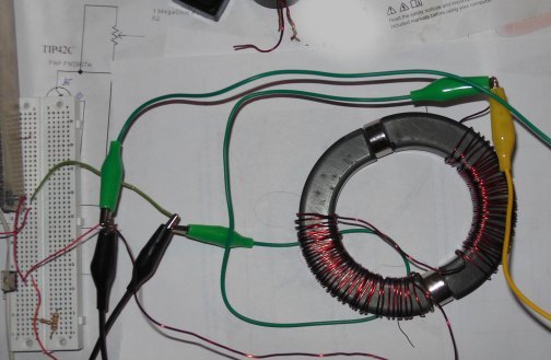

                          I forgot to mention that I threw a real twist into this circuit. As I didn't have a coil wound yet like ZPDM mentioned I just grabbed what I had laying on the bench which was a toroid split in half with 2 strong Neo magnets between the halves in repelling mode. Pic's of the coil below. I'll be trying it with a more conventionally wound coil soon. I've got another toroid this size that has not been split (about 4" diameter) I'll put a hundred wraps on.
                          So far with a little more tuning I have found that 1.5 volts input is optimal. If I go higher in voltage the output voltage goes DOWN! With 1.4 to 1.5 volts in I get 51 to 53.6 volts out. Current measurement is interesting as it appears I'm only getting 0.7 microamps out and yet it is charging a battery up. Even more interesting was that I was still seeing 51 volts output with 0.2 microamps when I disconnected one leg of the input to the FWBR!!! That's just ONE WIRE connected to the FWBR input and still seeing 51 volts output at about a fourth of the output current when it's connected. I'll have to look into whether power supply and o-scope connection might be coming into play with that though....
                          I find that with the pots I'm using it's hard to fine tune and hit that best resonant spot. Probably need a 500 or even 100 Ohm pot in series to better hit the resonant spot. When I do hit that point you can hear it in the coil and the charging rate increases greatly. I look forward to trying a number of things with it.

                          • #28
                            Did you measure the current here?
                            • #29
                              Later I was trying higher voltages up to around 4 volts but current input tended to stay around 0.5 amps when I was getting resonance based on sound and fastest charging as well as the o-scope signal. Very narrow band for tuning to get any charging. Too little resistance and current will go high to around 1.5 amps (with loss of all spikes) and too low it will drop to 0.0 amps and no spikes. It's not something that would appear to be even close to any free energy from those numbers but it is odd how it charges batteries with such low current output. One other thing I did last night involved an 18650 Li-Ion battery (large Li-Ion) which had dropped to 1.6 volts. Normally if they go below around 2.8 volts they are bad and not rechareable. My Li-Ion smart charger would not even try charging it. So I put it on my circuit above and it went from 1.6 to over 3 volts in about 45 seconds. At that point I stuck it on my smart charger and it was fully charged in a couple hours and has held that charge this morning. So it appears to be recovered.
                              I was also charging a NiCad pack for a drill and while not especially fast it was still charging it from around 10.0 volts to 12.5 volts in about an hour. It seems odd to me that it can charge at all when output seems to only be less than one microamp. My guess is something is doing charging that can't be easily measured.
