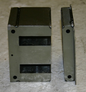

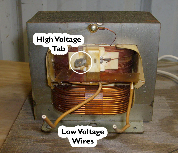

I have taken the top off the core with an angle grinder and am
looking to leave the secondary (high turns, low current) coil in
position, and bridge the gap between the LH upright and the
central large upright with the motor. The RH upright stands
unused.
If it works, it will be a very easy way to make a Lindemann A motor.
Here is a picture but photographed upside down. The other coil
is set aside. Also a picture of the naked core, on its side. The
central fat upright needs cutting with a hacksaw, a ghastly
job, to make a stepped upright, ending with thew same width
as the LH, and more space for the motor.Last edited by wrtner; 06-25-2013, 02:47 PM.
