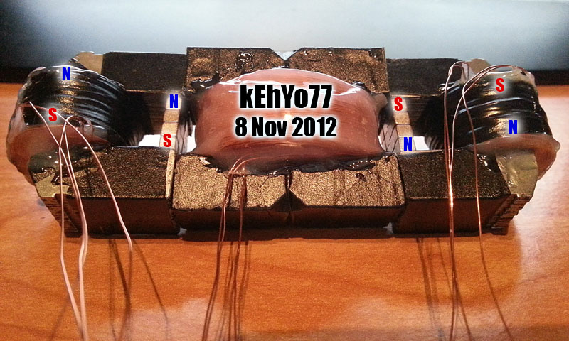

        I couldn't help myself... I will be testing this configuration

                Kehyo,
                I see that you are making progress. When you do the test, it is important to keep the air gaps between the iron cores. THE IRON CORES MUST NOT BE IN DIRECT CONTACT! I would recommend the following procedure:
                1) Verify with the scope that you have the correct primary voltage waveforms.
                2) Start with a maximum separation distance for the air gaps, let's say 10mm. Mesure the primary current a no load (secondary circuit open.)
                3) Connect a load to the secondary that draws a significant current, let's say 0.5A or higher. Record the primary and secondary currents and voltages.
                4) Repeat the steps 2 & 3 above for smaller air gaps 8, 6, 4, 2, down to 1mm. You can use plastic spacers.
                5) Create a table and graph their values. Plot the Ip=f(Is), Vp=f(Vs), Pp=f(Ps), Is=f(air gap), etc. You can use Microsoft Excel for these calculations.
                The above data should provide an important insight about the model of the Figuera's generator. This table can help you to design larger units.
                It will also provide information on how the air gaps affect the performance of the device. I cannot wait to see it.
                Thanks,
                Wonju

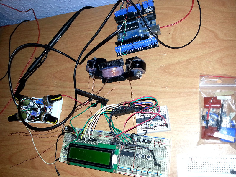

                          Hi Wonju
                          Do not worry, i go on the Figuera experiment.
                          My last video came from the fact that when i tried primaries with less Ohmage than the Micro Wave fan motor coil which has about 200 ohm DC resistance, i got no more the nice climbing and descending steps on the voltage trace, but i got a almost flat trace which ends with a sharp square with flyback spike. Almost as per a standard square wave .
                          Than i simply suppressed all the resistors and tried with the arduino (with your code ), and i got a kind of square wave , but centered on the middle of the cycle.And i got some interesting results. But i was very limited by the voltage of the Arduino , and when i tried to apply an amplifier with a transistor, i get a sharp square with strong Flyback spike. Seems not so good.
                          Today i wound the second C core (1000 turns of 0.3 mm with 14.5 Ohm DC resistance) so i have the real Figuera setup, with gap between the "y" and the 2 C core.
                          But with the Arduino and transistors ,i am not able to reach the nice trace, as per the Rotating commutator.
                          OK will go on with my rotating commutator to get the feeling. I will wait to Conrad or Keyo for electronic commutation.

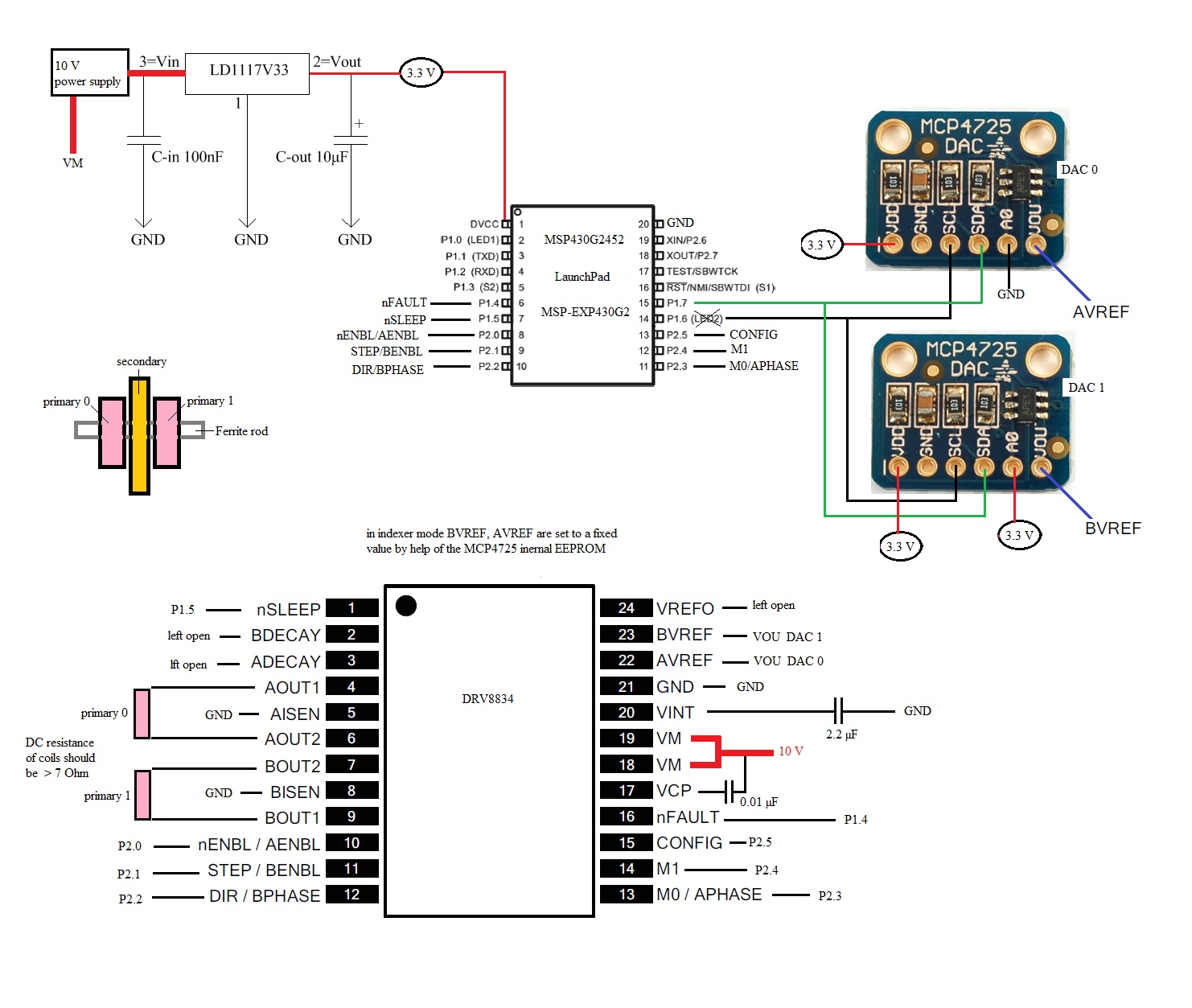

                            Circuit and first test transformer
                            See the attached schematics for the test system I will build.
                            For an initial test I will wind all tree coils (primary 0 - secondary - primary 1) on a Ferrite rod next to each other (the secondary will be sandwiched between the two primaries).
                            Greetings, Conrad
