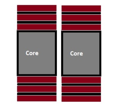

Today I am going to wind another "twin" coils...but this time I will be using 22 gauge steel lamination strips of same length of coil, sandwiched between each layer, same length, same gauge wire (23)...to observe if there is a difference with and without steel...and I am pretty sure it "should" be a big difference since field would be amplified at a "per layer" increase ratio.
I will be using this two coils as Exciters (primaries) as also as Induced with same Input conditions I had on Test 1. To observe if there was any improvement in both options.
The ideal way, would be to wind a full, continuous Lamination of iron strip from Layer 1 to Layer 26...but it can not be "Physically Possible" to wind Copper wire and steel strips at same time...so, this rings would do the job as well...closed.
Another option would be thinner iron laminated strips of say like 1/4 in, wrapped at each layer in the same direction of the layer.
I am gonna start cutting metal...and once I try on first layer...then I will go either option....don't want it "too bulky"...

Originally posted by seaad View PostUFO;
"Another option would be thinner iron laminated strips of say like 1/4 in, wrapped at each layer in the same direction of the layer."
Rings (laminate) with a slit? As my pic ?? /Arne
I decided to do full length of coil strips, closed (making contact steel start with steel end) like a ring...so, no slit, meaning, not open.
See, this laminated strips create a "Magnetic Circuit", not electrical...so, closing it would generate a stronger expanding wave for the layer beneath...and so on.
The smaller strips "spirals" will create gaps which make next layer uneven...and sloppy, plus more possibilities of shorting out if temp rises too much.
Plus too much work...

Steel coils
Hi Ufo,Originally posted by Ufopolitics View PostI decided to do full length of coil strips, closed (making contact steel start with steel end) like a ring...so, no slit, meaning, not open.
Ufopolitics
This is a bad idea. The added steel "circuit" is oriented incorrectly to aid the primary magnetic path. Magnetic-wise it will do as much or more harm than good mostly as leakage paths. But the real killer is the electrical aspect. It is a conductor. So expect eddy currents and loss associated with those. But even worse, the steel wrap(s) are shorted "secondary" turns which will experience high currents and get hot quickly.
Just my opinion.
Hello Bistander,Originally posted by bistander View PostHi Ufo,
Just my opinion.
I do highly appreciate your opinion, as I consider to be very valuable, thanks!
Basically, I am trying to "Enhance" or Magnify even more the Magnetic Field than just the center steel core does...
What if thinner strips are used...in a one inch length coil...to use LESS THAN 1/4 strips in an open spiral shape (not contacting each others)...which was my second option?

Core
Ufo,
Adding steel inbetween winding layers will not enhance the magnetics. If you want to add steel, put it in the core or extend the core to actually make a steel magnetic circuit. What you have now is over half air. As such, you have very high reluctance and low flux in your present core even with as high of mmf as you dare in your primary coils. In other words, with that straight bar core, you're not fully utilizing the steel now and certainly don't need to add more in the coils.
