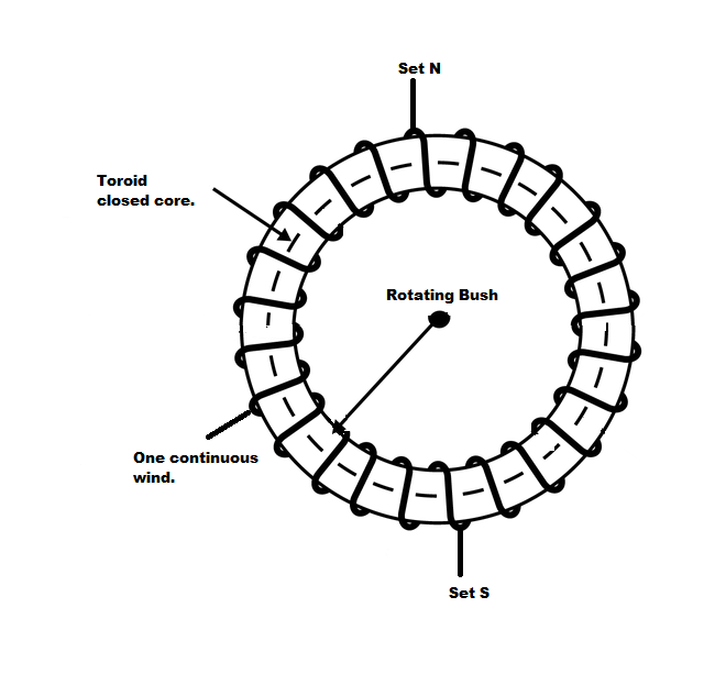

Originally posted by seaad View PostThe windings on the "G"-toroid between terminals to N and S needs to be
CW AND CCW to maintain the inductance in the toroid.
With all turns CW (or CCW) around the hole toroid NO inductance can be measured between the N ans S terminals or between the rotating connector to any of the N and S parts.
The Eagle
About your cited post above...You are wrong, the winding at Toroid follows exactly same direction at all times...So no CW and CCW at Toroid Core!!
What constantly changes here (reverses) is the Current direction at Toroid Core between both end terminals...even though brush is spinning through comm at same direction.
It is similar to a circular "Wipe Sweep".

Hi Ufo,Originally posted by Ufopolitics View PostNo storm at all Seead...maybe a "Storm of Happiness"...
What constantly changes here is the Current direction at Toroid Core between both end terminals...even though brush is spinning through comm at same direction.
Take care
Ufopolitics
Seaad is correct, as was I, in predicting zero inductance (due to zero flux in the toroid core) when MM continuous self closed coil is used. When that continuous coil is broken and the ends connected to the primary coils, current enters the toroid's coil from the brush (+) and splits left and right around the toroid enroute to the primaries (coil end connections). The split current in the toroid's coil will yield CW Ampere-turns to the left and CCW Ampere-turns to the right, or vice versa. So this effectively gives you the CW & CCW windinds on the toroid although, without the brush and rest of the circuit, the toroid's coil is in fact wound in a single direction, CW or CCW.
And I believe the current is always in one direction in the circuit. *
{edit} (*) Does not apply to all currents in the circuit.Last edited by bistander; 11-23-2016, 05:30 PM.
Hello Bistander,
Sorry but I disagree about Seaad statement...he clearly states that the winding at toroid must be wound CW and CCW...and that is completely confusing and so far away from reality.
As I also disagree with you about current traveling only one direction...only if you would have built this system, then you will realize what is going on here.
Remember when you posted a while back about your opinion on the Figuera method to joint comm elements in that fashion?
Your answer was that it was just "saving" some conductor wires...which we could interpret that by doing it in a continuous order was exactly same thing...negative.
But do not feel bad...there I also agreed with you and did not see what Netica carefully observed and built following EXACTLY the Patent Guidelines.
If you take a closer look at the set up...you will notice that positive brush riding on Comm wired at Figuera style...is FORCING Currents to Reverse every Half Cycle, kind of a Wiper Movement from end terminals.
And NOT following a Sequential Orderly Fashion, in which case Current will flow only one way..plus split as you are writing above.
The splitting of current is done previously by the way upper and lower terminals on comm are joint (or right and left, depending on your end terminals line positioning at comm).
As this is also the way Netica sees this...
UfopoliticsLast edited by Ufopolitics; 11-23-2016, 04:49 PM.Principles for the Development of a Complete Mind: Study the science of art. Study the art of science. Develop your senses- especially learn how to see. Realize that everything connects to everything else.― Leonardo da Vinci

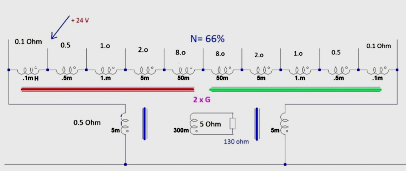

Last "Figuera" sim LT-spice XVII Dual G-part
Simulation 66% efficiency. Here with TWO separate G-cores. Sine wave 1000Hz
The same N,S,y transformer parameters. Load 130 Ohm.
I have tried the same concept at 50Hz also with different inductance values. That seems to be a much tougher task to solve. My best result so far is a power factor just below 50 percent.
Compare that with the flip flop version post # 1325 => 67% Square wave
It will be interesting to see if any test on the forbidden thread can outdo my simulation* power factor values with open G-part coil(s) ends as in UFOpolitics latest video
https://www.youtube.com/watch?v=VXWLV76XfFw , of course.
With a MM continuous closed coil G-part** that is no trouble at all to achieve >100% because of the resulting OU- effect!
MM quote: i will still pursue my style of winding just for my own sake
*) with normal laws of today
**) See picture below
