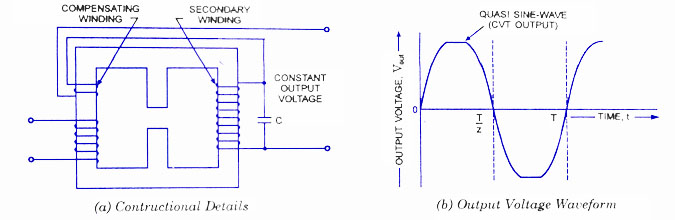

I was recently having a discussion with the chief engineer where I am employed about CVTs or Constant Voltage Transformers. He sketched out his rendition on the blackboard and like the pic here, it had three windings, except in his drawing, the center gap was closed with the 'resonance' winding wound on it, connected to the AC capacitor. Then, a Ta Da moment happened. Look familiar? Sure, the H-shot cap/coil assembly isn't necessarily 'ferro-resonant' (no real iron mass), but the topology is very similar. Could we make a guess that the H-shot cap/coils are really CVTs, only at a much higher frequency? The cylindrical cap and the outer winding serve as the resonance feedback for the other three windings? Couldn't help but notice the similarity, as I had never noticed this aspect before. Food for thought.
Professor Tinkerer: I've seen some Hendershot schematics that show the capcoil cap connections similar to what you show but I haven't spent any time with them yet. I may get back to that later.
