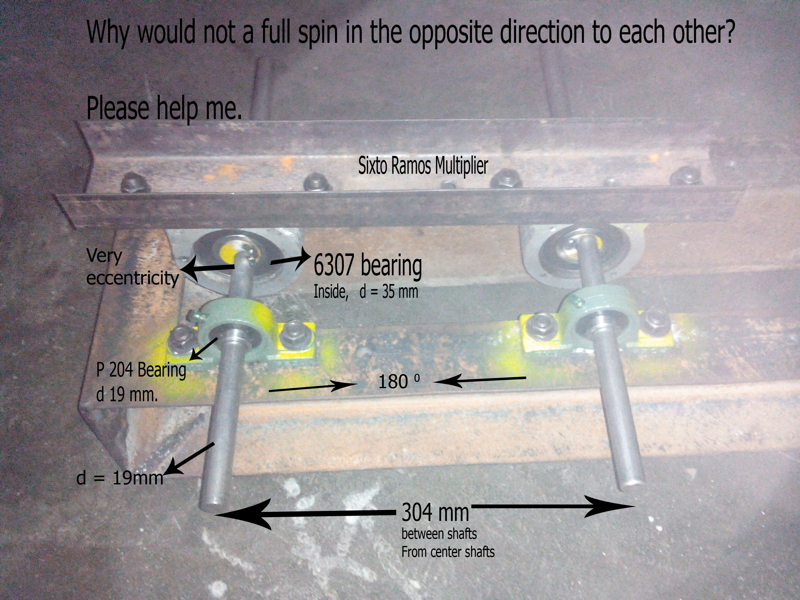

    I have 4 bearings P 204, Inside diameter d= 19= mm, 2 X shafts diameter d= 19 mm length 500mm & 2 bearings 6307 Inside diameter d=35mm. it's very eccentricity. Length between shafts from centers is 304 mm. Look the images. Why would not full spin in the opposite direction to each other ?. Please help me.Click image for larger version

      Hi Ralyn, make sure both eccentrics are the same as the centers, that is 304mm apart. If they are not the same they will lock against each other. I even had the centers of the eccentrics as far as 50mm on a similar unit. Regards Arto.

        Hello ralyn,
        Looking at your pic it appears that you may have tried to weld the shaft and bearing. If you have the shaft will most likely have bent a little which would cause the problems. This is why I only used certain glue and polymer steel, I tried many before I was happy with the ones I used. I also used v blocks to make sure everything was square.
        The set up for this has to be perfect. You really have only the play in the tolerances of the bearings themselves to play with which isn't much.
        • I've done it. I replaced 4 times already. I'm sure both are eccentric. But I was the first successful experiments using P204 bearings d = 19 mm & P206 eccentric bearings d = 30mm, the distance between the shafts 304 mm. Why the P204 bearings alloy d = 19mm and eccentric bearings 6307 d = 35 mm, 304 mm distance between the shafts can not?
          Thank's Artoj
          • Yes, I had to weld the shaft and bearings. but I also have been using v-block to ensure that its axis is not bent. I've replaced it 4 times. Is there any influence of the distance between the two shafts?
            • Have you got it working yet?
              I don't think you have to worry about the distance to much, I tried to get it close, relatively to what I saw on video of Fernando's machine.

                thanks, I've managed to make it., second wind wheel spinning in opposite directions fully. Now a new problem arises why my generator 1 kva 220v is not able to loop electric current electromotor to my 1/2 hp 2980 rpm 220v?. how sixto ramos make it loop? which occurs more slowly and stop rotation.
