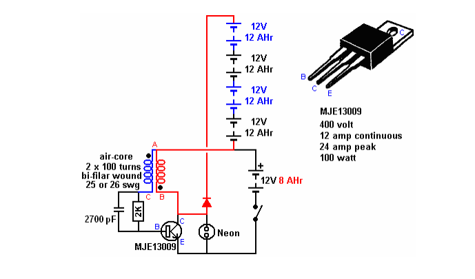

                    Hi everyone,
                    Been a long time before a finally got round to building Alexkor's self-charging circuit. (not the improved version mind you, but with the neon bulb in it)
                    However, I would like to ask whether anyone here has any ideas what I'm doing wrong here. I built the circuit with all the components as mentioned in chapter 6, but my transistor heats up really hard & fast, so I've had to shut things down within the minute every time. First time I connected it, it was up to over 100 degrees C because I walked away to get a cup of coffee. And I'm afraid that I am a bit of a newbie here, and have no clue why.
                    So any pointers/thoughts would be really appreciated :-)
                    I would of course post any details about the setup, but I don't really know what would be helpful when I made the circuit exactly as described...

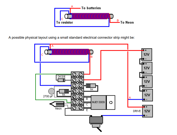

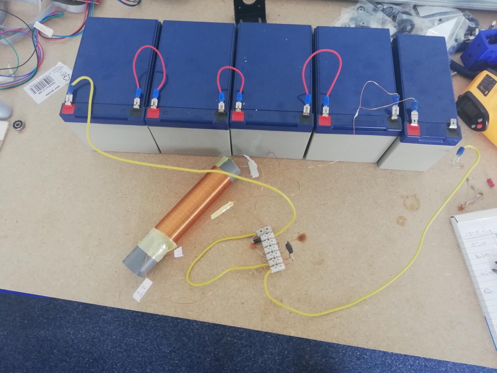

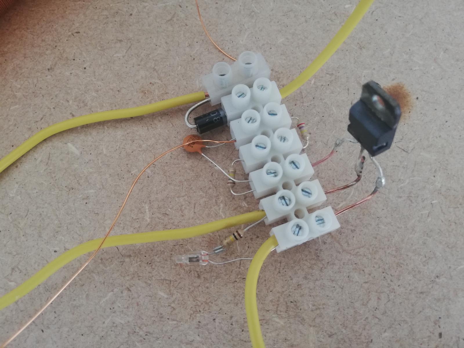

                            • Hi Skywatcher & Pot head,
                              Sure thing. The components I used are as described on page 6-33 and 6-34 of the pjkbook:
                              - swg 25 wire
                              - 2700 pF ceramic capacitor
                              - 2K resistor (2x 1K in series to be exact)
                              - MJE13009 transistor
                              - 1N5408 diode
                              - neon bulb from reichelt.de
                              - drive battery: UltraCell 12V/9Ah VRLA/sealed lead
                              - charging batteries: Ultracell 12V/12Ah VRLA/sealed lead
                              I've tried to tone things down a bit in terms of the transistor heating up by increasing the resistor value to 360K(!). Now it does indeed stay slightly cooler, but I've seen no actual charging of the batteries, it just seems like the power from the drive battery is converted to heat in the transistor without much else happening.
                              I've attached snapshots of the circuit diagram and the suggested implementation from the pjkbook, as well as pics of the setup and a closer-up of the strip with components.
                              I picked this circuit because it was simple, and wanted to use this as a starting point for learning more. Seemed simple enough, right? ;-)
                              So any suggestions would be most welcome!
                              Kind regards,
                              OT

                              • Is that copper wire bare? It looks in the picture like it is just plain copper wire with no enamel coating. You have to use enamel coated copper wire or more commonly called magnet wire. Just like the kind used in electric motors.
                                Have you tried powering the circuit with the charging batteries disconnected? If you do that and the neon bulb does not light up then you have a problem in your circuit somewhere. Do NOT run it for long like that as the spikes can blow the transistor. The neon bulb is there to catch the spikes but you still get some getting to the transistor.
                                Also do you have any kind of test equipment such as a volt meter?
                                After you answer these questions then I may be able to help you figure out what is wrong. It appears you have everything wired up correctly as far as I can tell from the pictures.
                                Carroll
