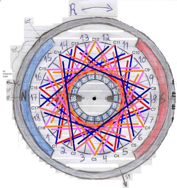

    Hello UFO and all
    THis is my drawing of how i'm winding my 18 poles motor...
    Could you UFO Please just check it if it is correct?
    I used the idea of the 12 pole motor...
    The brushes are horizontal in my motor...
    Should i change the angle of one of the brushes?
    the blu colors are north
    and red are south...
    i'm using 10 turns per pole coil summing 20 the north and south pole in series... for each collector...
    Thanks again
    Fabio

          • Hello Sebosfato,
            Originally posted by sebosfato View Post
            Hello UFO and all
            Thanks again
            Fabio
            Hello Sebosfato,
            Well, I see some things I do not like...You are not using color codes...just in one or two coils...then I see, orange and magenta together in one Pair?...
            Whenever you use Pairs, One MUST BE a derivative (shade) of Blue or Green related to NORTH...Then South are REDS...ORANGE and Magenta, Gold etc...This way we ALL could easily read a diagram...Ok?
            Now, you are writing "C18"...Coil?...Coils?...I have clearly shown P18...Meaning PAIR, Pair of Coils...not "Split Coil, not Coils...When I am referring to just one Coil, I write South Coil of P12...
            It is VERY IMPORTANT, We ALL use same color codes
            , same exact names...when referring to this technology...that way we have a COMMON LANGUAGE...that ALL could understand...Please!
            Now, here you have a numbered sequence of just numbers...1,2,3,4....18
            Then You have C1,C2,C3,C4....C18...?!
            I had to "Figure out, guess" you meant when you wrote just numbers are your POLES...and the "C#"...Are the Pairs...Right?
            I hope...
            Now, getting "finally" to Machine disposition...I see "Conflicts" between Commutator sequence and their corresponding Poles sequence...they are "Out of Phase"...for some reason you have moved the Commutator Elements Numbers related to Pairs corresponding numbers...
            Look again at my matching Diagram related to Brush positioning and Stator Diagram...below...
            [IMG][/IMG]
            Now look at P4 at Poles Pair center and also to Commutator corresponding element...which is right at Motor Brush...then look at yours...right at Motor Brush touching "18"...then look at "C18"...they are Out of alignment?...right there you are just using a Repulsion from North (barely, too close to Bisector center vortex...) and not using the Attraction from South Pole Stator...
            It should be energizing Pair 16...more or less...not perfect either..
            @ALL: You all have to pay a bit more attention to my explanations and my very clear color coded diagrams...basically, when winding complex structured wiring machines...
            I am sorry, but I really do not have the time to go over "One By One"...here, as this Thread will keep growing up...so please concentrate and analyze as best as you could each machine diagram...and do not take assumptions or break simple codes...it takes time for me to "debug" all mistakes and random changes from "Original Set Up Diagrams and Explanations" that You "decided to do ...
            I will really appreciate that...
            UFO

                          Hello Sebosfato,
                          I hope...
                          [IMG][/IMG]
                          UFO
                          I'm downtonic... i thought magenta was a kind of blue...
                          and for me the pink and orange has red in them ...
                          The C1... i wanted to mean that the pair indicated is connected to commutator 1 position. and so on is the same as pair one, two...
                          the big numbers are the marks i made on the poles just to localize myself...
                          should it work from what you saw?
                          Fabio
