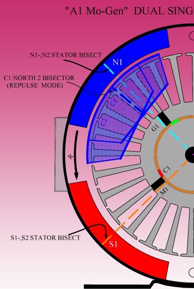

    Hello my friend Midaz, Hello to All,
    Ok,Midaz, after we exchange some mails, I think I've got your idea and points.
    This concept will work, no doubt about that, and I believe you are right about concentrating the magnetic field within a single coil will 'compact' (let me say it this way) the strength in lesser poles and will not split coils in two. This splitting deviates the bisector angle,or it becomes two bisectors...either one, and yes, it will weaken it somehow. I was going by flux transfer at common shared coils from one to the other...
    I like to try this in a Radio Shack first...and see what it does.
    If I got it right, the CAD Diagram should look like below:
    The only thing that must be done for it to be timed properly, would be to move for a short angle the brushes towards the rotation sense...like 5 to 10 degrees in order to avoid bisector engagement between stators and coil being fired.
    Either move the brushes...or rotate both commutators to proper angle (counter to rotation) when assembling rotor, then have brushes at exact alignment to stators center.
    So, yeah, let's give it a try friend...we never know, we are all experimenting here....and this is a 'Democracy' here in the Open Source spirit...
    I like the simplicity of this configuration...and like I said...You are right, it makes sense...You may have seen what I have missed prior when dissecting the three poles and starting to walk into the All North concept.

      Nice CAD Raul/Ufo but...
      Originally posted by Midaztouch View Post
      Can you ADD extra brushes to either designs to collect the collapsing field? I don't want to reduce the performance of the machine/magnetic drag.
      In your opinion, is it possible to do what I'm saying? Because anything besides that would be a waste of time. Don't you agree!?
      Midaz
      As soon as P2 and P16 gets fully disconnected from Input, this coils would be in a kind of "limbo", where their previously oriented domains with North direction would get somehow in a 'loose status' just for nano seconds, then easily influenced by both South Stators Magnetic Fields...this would cause a Counter Orientation of the ferromagnetic comprehended core, which would be completely "compatible" with the natural collapsing field and Voltage polarity reversal.
      We must realize that every time a ferromagnetic core approaches a magnetic field Pole, the field will "expand" and that specific Pole will take over that portion of the core under the inflluence.
      IMO, at this early, primitive stage is too soon and too close to start collecting energy (by setting extra brushes), since it may create "Influence Conflicts" with the Coils being energized by direct input, since they are too close.
      I recommend to set the Generator Brushes further away as possible from this 'conversion' stage, and as closer as possible before entering the next Input Cycle, this way we will 'suck out' all the reversed plus the induced energies, leaving a "Blank" clean Coil to receive next input, resulting in much less sparking.
      However, all this are just assumptions based on magnetism and electrical behavior 'theories' as well as "not theories but reality", however, complex interactions requires that all of this must be tested/checked at different angles in order to determine which setting will deliver better performance and output.
      Just my opinion.

      It seems like the A1MoGen meets the requirements.
      With the Singular Coils = A1MoGen, I believe that you can add extra brushes to collect the collapsing field... There is plenty of room to add the extra brush with no interface.
      Look at the CAD. They fit and with with room to find that "Sweet Spot". Don't you think so!?
      UFO
      The only Chance we have to get maximum performance and extra brushes, is with the singular coils = A1MoGen.
      It's seem to me that pair winds and group winds there is NO possibility of adding extra brushes to collect the collapsing field without hindering asymetric motors.
      Not to waste anyone's time... shouldn't checking the extra brush and Singular Coils be the main/top priority!? Wouldn't you agree?

                            [IMG][/IMG]
                            Now, the "Perfect Neutral
                            ---S---
                            [IMG][/IMG]
                            This CAD's are NOT PERFECT, since I have NO MEASUREMENTS OF THE REAL ROTOR, COMMUTATOR AND MAGNETS RADIUS AND ARCS SEGMENTS CIRCUMFERENCES...
                            THE SIZE OF THE BRUSHES DON'T MEAN SH*T...BRUSHES COULD BE MOVED AROUND AS WELL AS MODIFY THEM AS THE BUILDER PLEASES TO...
                            --S---
                            @UFO
                            It is my understanding that we have agreed on all the critical angles making up the connect/disconnect sequence including the 'final agreement' which was including the brush width in the calculation...the sweep angle...the roll off angle or what ever we want to call it.
                            We are both at a disadvantage, it seems, by not having the complete motor specs. But in fact the only critical spec missing from this 10 pole arrangement is the brush width which is very
