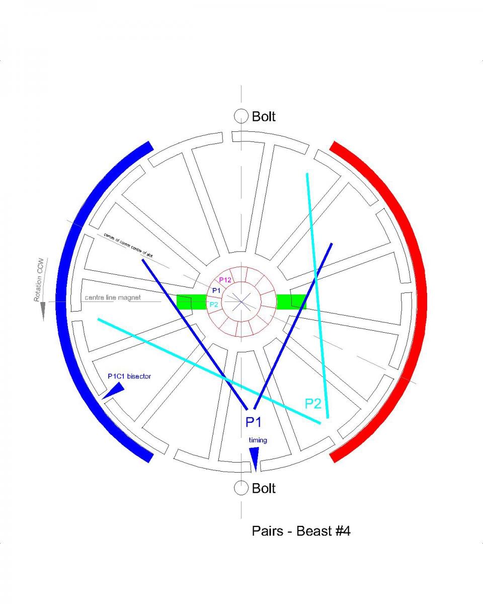

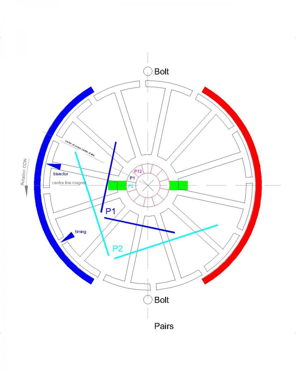

Is the Timing the same as the factory?
Do to the wind of my design, "Singular Coil", the wind only interacts with one magnet for the 5 rotor pole motor. The timing of the positive input may need some adjustments. As you get closer to TDC, the torque and RPMs will increase. For adjusting the positve input timing, I thought about the RPMs & torque vs power consumption. RPMs & torque vs power consumption equation should be as balanced as possibe to the OEM.
Do you have a clear pic of the winds for my design? The pic is too blurry for a closeup view.
