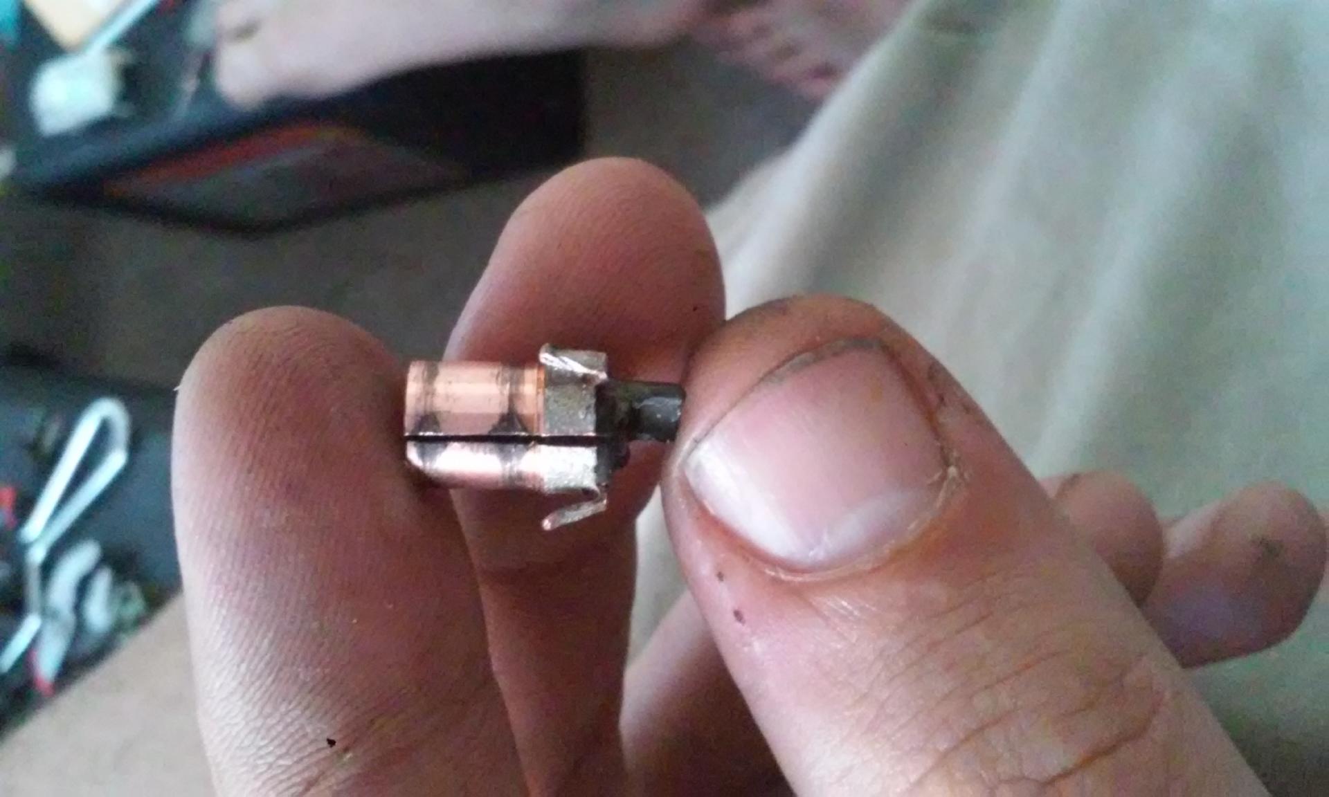

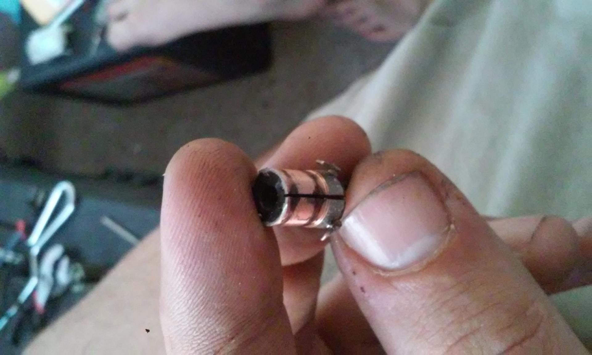

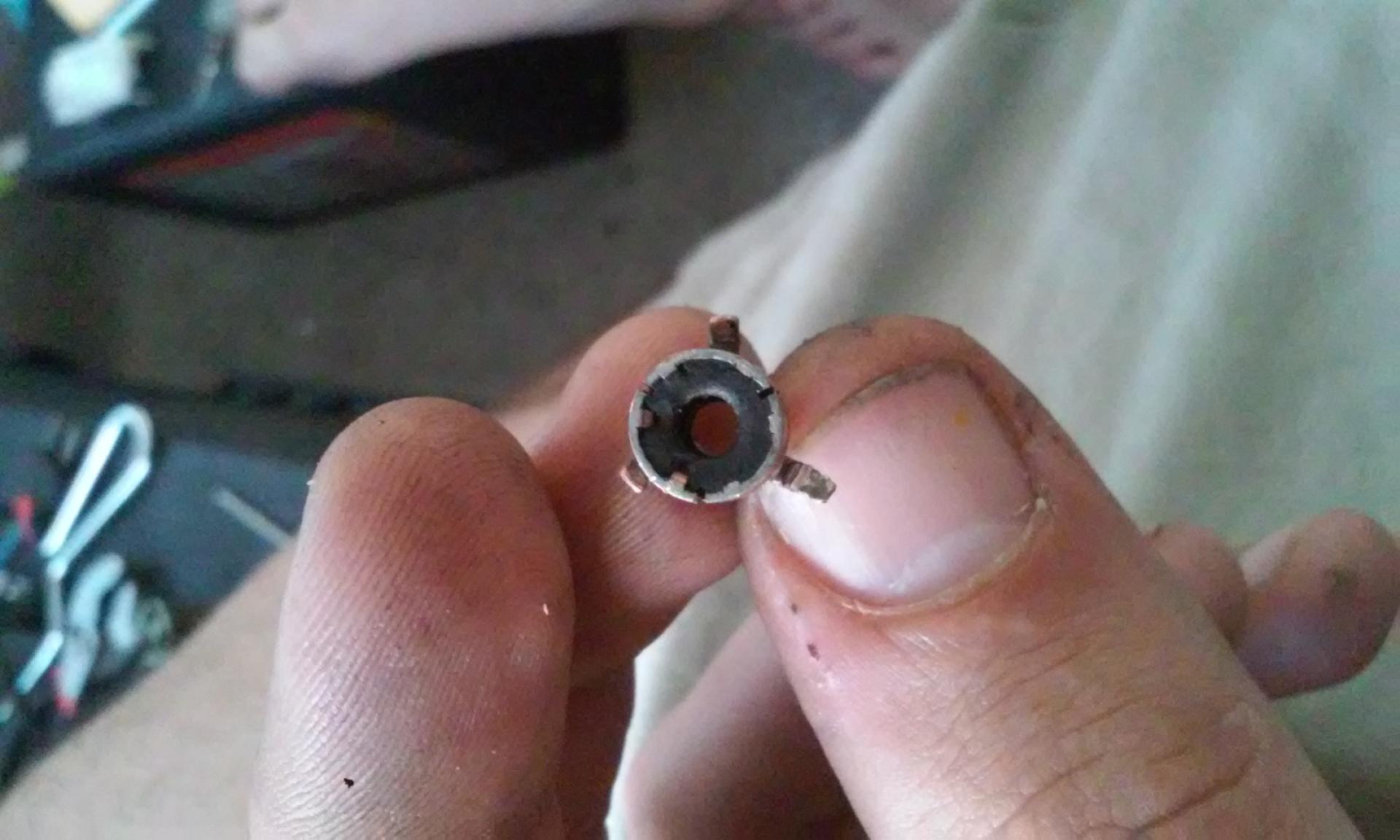

                      Yeah on one motor i tried to pry the tabs with a small flat head but eaded up prying one of the copper contacts off the comutator...is that fixable? its a pretty decent 9v motor for a dremmel..
                      My main motor is an 18v motor from a cordless drill I have 2, 1 for extra parts i.e second comutator etc.. Question, does anyone have experience with taking the gear off the motor that runs the gear box??? I pulled and pulled and pulled to no avail
                      As to the gauge of wire does the more wraps increase ohm or is it gauge wrapped? would smaller gauge for more wraps to equal 1 ohm be better than a larger gauge with less ??

                      • Originally posted by YahwehisSpirit View Post
                        Its Yahweh is Spirit.
                        My electrical technical fire has started again, it hasn't burned like this since i was told what wasn't possible for electricity. A really crazy one is I was really really into radiant energy and got deep into it in 2010 but in 2011 i went and lived in the woods for a year and came back june 2012. When i was into it there wasnt much video to watch on youtube about overunity well not much with alot of meat and what was there you had to dig and dig and do aloooooooooot of reading. Ufopolotics I am greatly appreciative for Yahweh opening your eyes to these simple truths that unify us in his pattern
                        I have never had to fix a broken comm sector but I suppose with reasonable care it could be bonded with an appropriate adhesive. Getting it lined and level sounds like a problem, if it's proud of the true face then the brushes will suffer. Go for small sideways twists and you'll feel the tab release.
                        I recently read an 'Instructable' on cordless drills being chopped for robot builds. It covered the left hand threads and small lock screws, so I think that would give you all the info required to strip one down. It didn't seem that excessive force was required.

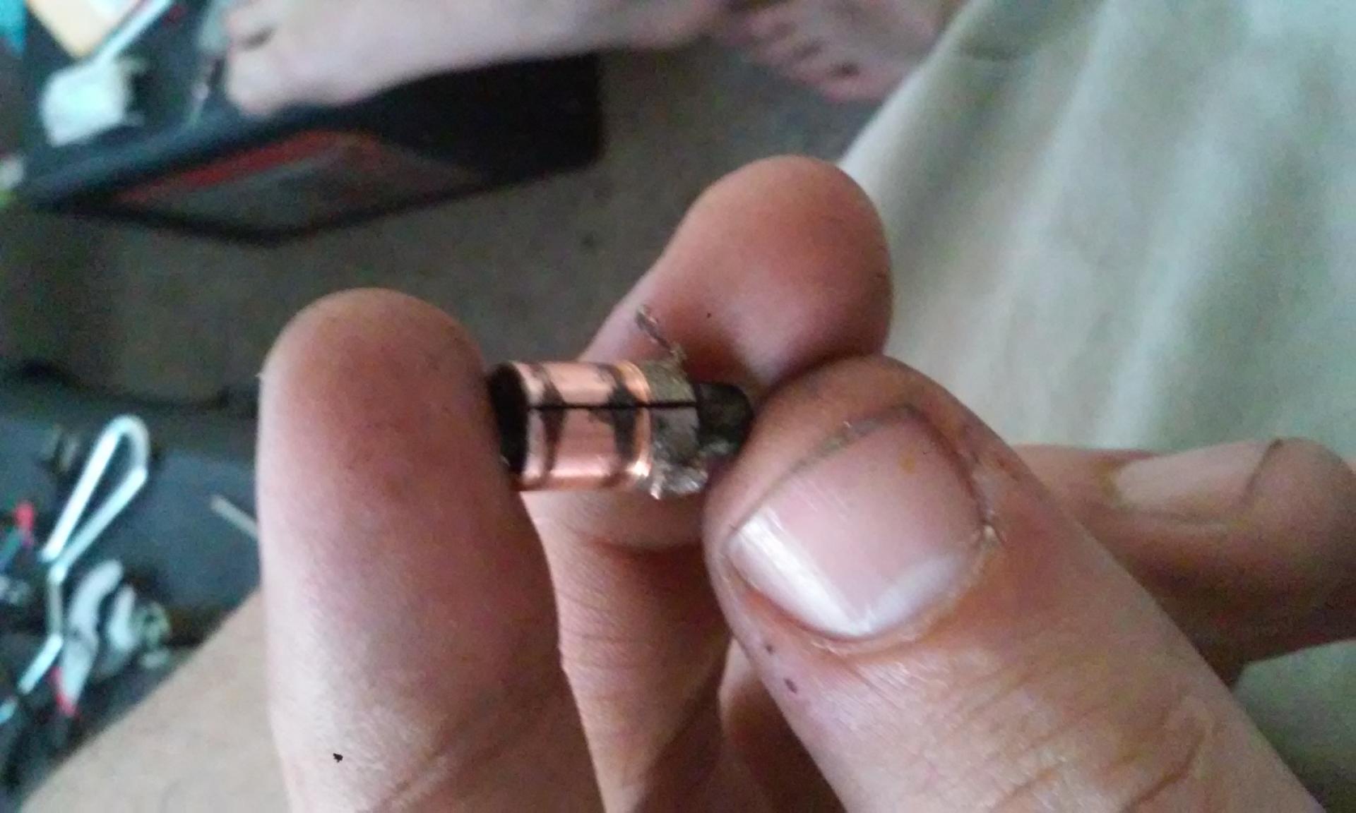

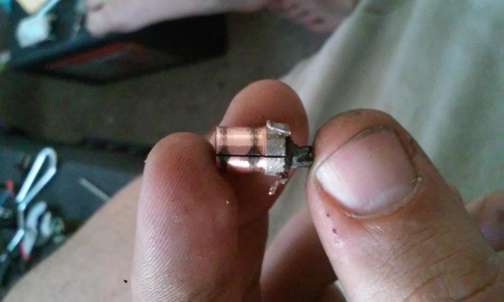

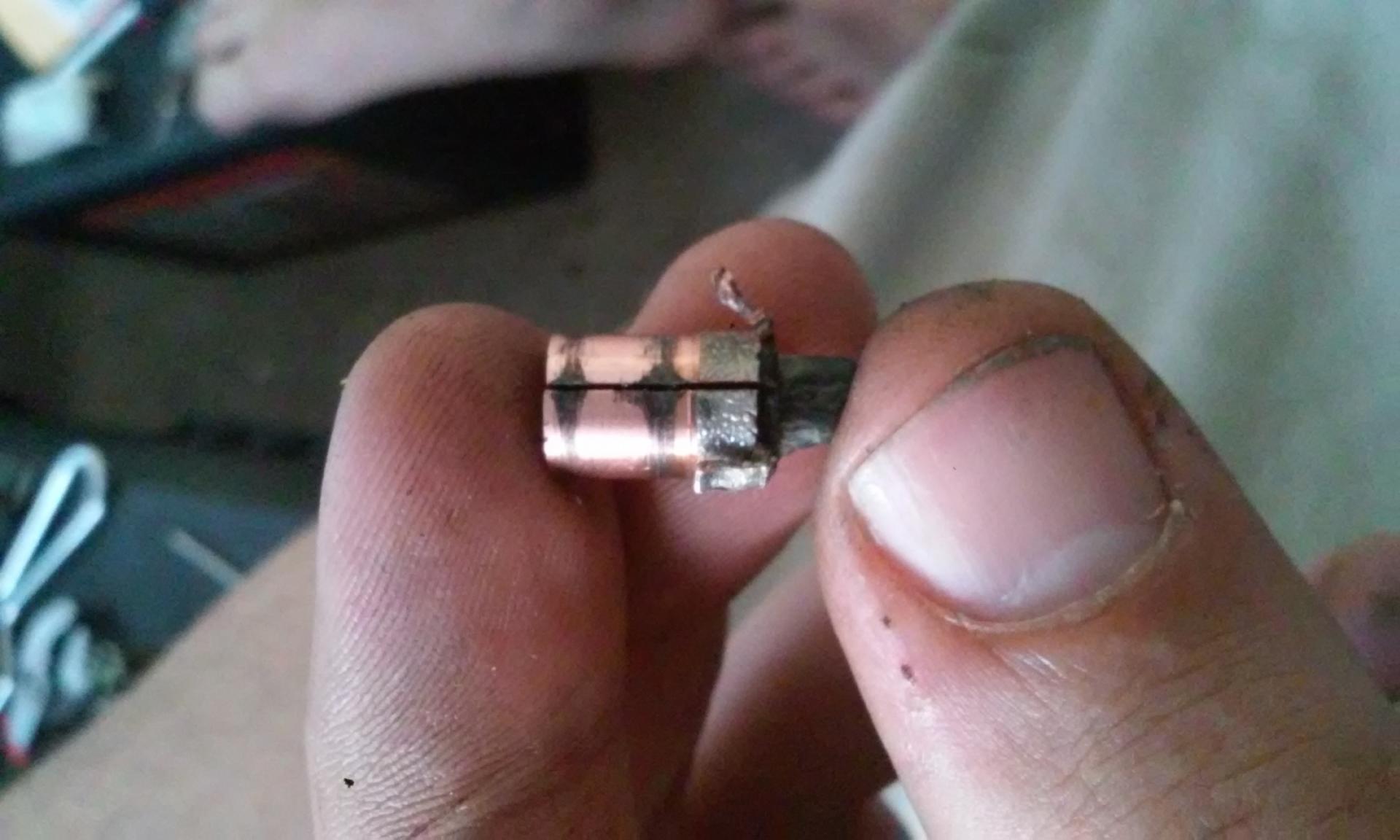

                              ok so i managed to pull the tabs pretty decently but i damaged it a little bit when i was getting it off the shaft. I thought i cut off all the bonding on the shaft but not all Im posting some pictures can someone tell me if the comutator is damaged beyond use!!!!!
