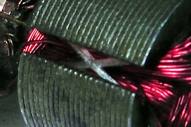

I shall rewind this motor with more finesse using 0.425mm (solderable) so I can ensure proper connection and lever those tabs up for a good mechanical fix. I should be able to get 10m of wire per group. The wire is quoted at 0.121 ohms/m. Hopefully that sounds good ?
12polemotor.jpg Photo by huntingross | Photobucket
A described before the G1 comm is coming onto the brush with G1 Coil 1 bisector past the midpoint of the magnet.
