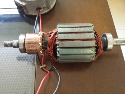

    exploded view shows rotor winding completed, how I balanced rotor, and endplates. Just used those letter openers as steel rails for the motor to roll frictionless on a level surface. stuck 18ga wrapped steel wire on one site to get it balanced, as wire hedges, fit snug and glued. use wood hedges on the other slots, glued.
    Estimate 1.1 ohms per coil. Ran the motor, on 12v. one brush set 3200 rpm powered, 8v out of the other, 1.5A, ran at hottest point 110degF
    Good job Sam!
    Powered both brush sets the same battery: 3900 rpm, amps on the firsts coil dropped to .7A.
    When you powered both brush sets...you meant like parallel connect?...or with a rear jumper and top feed?
    That's a lot of amps drop off
    Couldn't get a reading on the amps on the other coil for some reason. (Multimeter issues?, tried 2 or 3), but even so looks like rpm went up and amps stayed the same if you figure both coils were taking the same amperage. I could stop the motor with my fingers on one coil, probably not on 2. Pretty interesting how much the amps dropped on the one pair. Try to get some video soon
    My Quad stator pentagon winding motor did 7500 rpm on one brush set if I remember right, drew 2.5A, 8600 with 2 brushes. I think I had .7 ohms per brush set though, got up to 130 dF the day I blew a brush set, used solder. so it needs reworked.
    One question...are this two motors (Quad and G-10) same spec's as rotor wise?...If so, could you run the G-10 Rotor inside the Quad Stators/Brushes housing?
    This motor is too stiff to turn yet, no where as loose as my QP10. Gotta look at brush tension again, pretty sure it isn't binding. If the brushes are sharing the amperage equally then I got more rpm for the same load when running both sets in parallel. The commutators are looking kinda dirty too.
    Mechanical drag, due to misalignment or rubbing parts is a killer for performance my friend...
    You can see my QP10 run on UFO's site where I earned honors for that job!

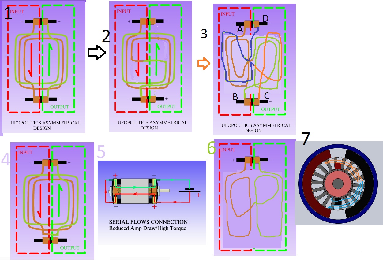

        Hey Sam,
        Next time try to remember when this happened on the bold letters above...it is important to know in which connection this counter force effect occurred.
        no can do. The dual stator was a double rotor - 4", the quad was 2". I hoped to make up for it being only a dual stator by making it longer, and of course, putting the two bodies together was easier, since you could duplicate the original motor's brush and endplate assembly to the commutator placement, no thinking and simple measurements to dupe.
        In this research and development we are all in... it is great to be able to switch models...like having a solely housing assy, where a few armatures/rotors fit perfectly...and maybe of different pole numbers would be even better....but still being same number of poles, like in your case 10...to make a Group and a Pair config all north...then run tests on the same housing...saves time, money...and come up with results much faster...all we need to do is to film them separate...then add a video with both comparisons.
        It would clear all doubts right now...as which one of the windings works out better.
        yes absolutely no adjusting. I think a big drawback now to these motors is the magnet's are shorter in width as I posted earlier on this page. The motors are made to be narrow to fit in a door Bad for doing real work as I have some plans on seeing how much energy it can make. But I am happy with the ohms per group and heating seems very under control and will look at 24v. I think I used 26ga on the quad and it had .6-.7ohms per coil, and the brush assemblies are just not heat tolerant, failed a brush set fast (haven't disassembled yet to find out exactly). Pretty sure its best to pursue your unipolar windings though instead. I would rather rewind it that way, before I do anything serious with it. I might try to repair it just to get good comparisons to the unipolar. I would almost say that I should go up a gauge to 27ga on it also, since it ran so hot. But maybe need to get the pulsers working to see how they help.
        Yeah, that's a draw back on the window regulator motors...this motors need adjustments...not only at neutral timing everything is gonna work out just fine...plus, the other thing is...this motors have a pretty small sized circumference...if you notice the commutators are almost same size as rotor...not good either, in order to have high RPM's we need the rotor drum to be pretty wide...taking it to any scale...small or large types.
        For example, look at the Radio Shack motor...pretty big circumference rotor for its size...then look at its commutators...very thin...small timing there...
        I have enough rotors and commutators to make a new motor core methinks pretty quickly. Many serious home front priorities now however. Yes could there be a possibility that your original RS unipolar pairs is a better design? A new rotor winding of that type would be the ticket to answer that!
        The Group Windings favors the Generating side of this Machines...not as much the Motoring side...
        The ideal deal, would be to obtain a way to please both worlds without the need to do separate windings for each operation (motor and generator)...and I believe we are closer to achieve this in Group windings, rather than Pairs.
        But definitively the "All North" design prevails over the North-South old concept...there is absolutely no doubt about that fact.
        In order to understand why Groups benefit generation of electricity is simple.
        In Pairs we have exactly Four Columns of vertical wires that Generate electricity passing in front of stators magnetic fields...no matter what configuration or number of poles we have...and out of those four columns, we have two that are exactly within same space-time sweeping the magnetic field.
        All those attributes above are not good for generating electricity...however, for motors they are excellent.
        In Groups...we could bring your ten pole as an example...then realize we have Four Coils in each group...that have Eight vertical columns of wires...where only TWO(2) are sharing same slot (Coil 1 end & 3 start)...and all those seven columns are running through the magnetic fields at different times...which enables a huge generating gaining potential through time (RPM's)...actually typical generators are wound exactly like this.
        On the Motor side, like I said on my previous post...Groups winding widens what is a very centered/compact in Pair type, related to bisectors/center of the rotor magnetic fields...this weakens the strength of each interacting motoring field...
        But I already figured out a possible solution...an alternative to favor both worlds, using same type of coils modules...and that is to wind them with heavier gauge trying to add as many turns as we could, per each coil in the group...depending on each different configurations allow Us to do, of course.
        Heavier Gauge wire will generate a stronger field for motoring, even with lesser turns than we may have had in Pairs configuration...plus heavy gauge will generate pretty high currents (amperage), electricity.
        Anyways Sam...I believe until we build a Four Stator system with Groups in a large motor...we will not know for sure if they will be successful or not...We need Systems that are "compatible" with all kind of configurations...either Two, Four or Six Stators (MAG3)...
        Take care
        Ufopolitics
