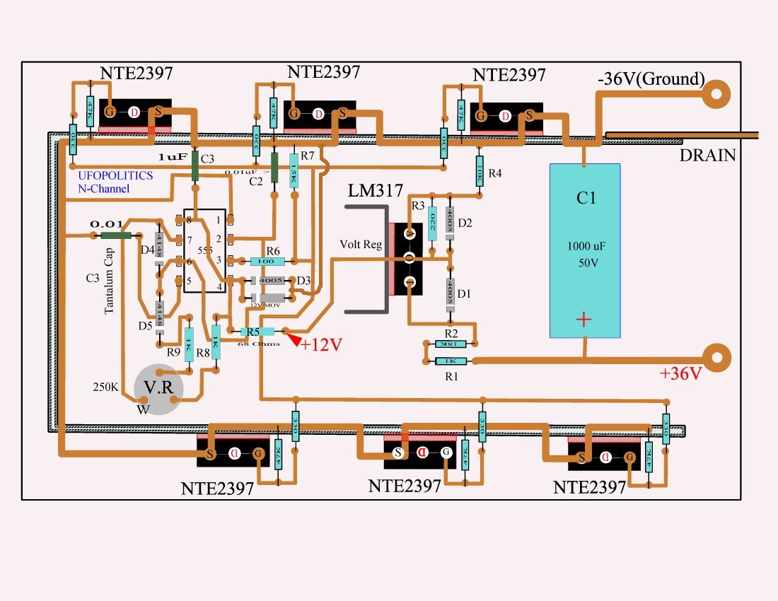

    I made a new 6 Mosfet controller the same as I used in my coil pulsing circuit to light the 5 CLF bulbs it was drawing 0.2A @ nominal 36v no load speed was around 1800RPM? (the meter I could not adjust exactly)under load using the 2 sticks of wood was 5A the motor was very hard to slow down.
    I have wired up just temporary connection#1 as you suggested so I made sure I understood what you are saying the amps draw was 1 amp and the output was fluctuating between 50v 78v I did not measure the revs
    When I put a load by jamming the shaft with 2 sticks of wood the amps jumped off the 10 amp scale the Mosfets were cool still and the motor was cool
    That was great test, the point here is that you observe the Voltage out, even using the brushes in parallel at output, it is understood that if you would have them in series, voltages would add even more than that.

                              • mosfets
                                Dear Sir / Team UFO,
                                Namaste.
                                I checked my fried out mosfets - irf840a. in all of them gate and drain shorted
                                can you pl look into the datasheet of irf540n at
                                and let me know whether this can be used in the circuit in the place of nte2397?
                                And I'm not able to get 12v mov to complete the 555 circuit. In case I go forward, what adjustments are to be done in the circuit diagram?
                                regards and namaste
                                kumar
