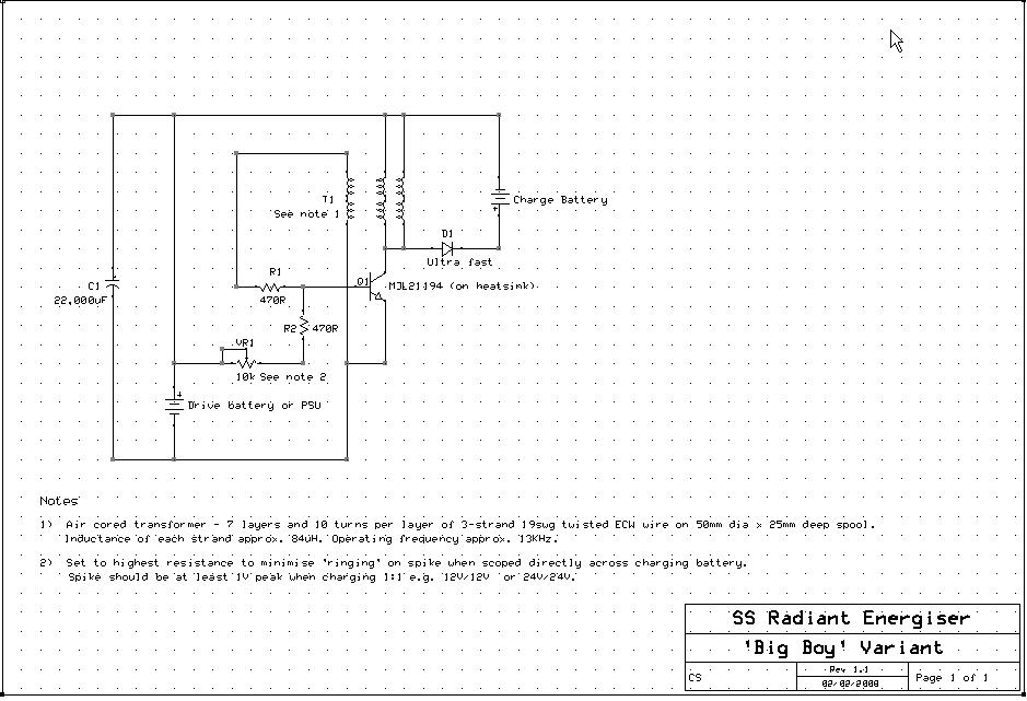

              Since this is all about switching I will explain it to you.
              The Joule thief circuit is a closed loop system ( Closed Transformer) This is where science has you brainwashed. You do not need to close the system as this is a limited device. It draws gobs of current right to the end.
              The Radiant oscillator can be wound to do the same thing not closing in the magnetic fields. The Joule Thief can be made to use low current just by changing the base resistor this also will change the frequency of the oscillator. Since your running Led lights it make no difference.
              If your clever you can run the circuit while charging another battery in a series configuration with the led's. Just change the base resistance and the transistor to a much bigger device.
              The small plastic devices are for led's and not for CFC lights. Make the transformer with equal turns for the oscillator, then add the secondary winding, then adjust the base resistor, then protect the base to emitter junction with a diode. Yes I said diode you must limit the base current to .7 volts max, you will find that your transistor is in cross conduction current, "that is heat". You can do all this with an open loop transformer like the SG.
              JB

                          • Hi folks, Ok I finally have found the best oscillator circuit that has good adjustable drive and doesnt heat the transistor, it was one posted by Ashweth I believe or someone in the Bedini solid state thread. Here it is, for those needing a nice oscillator circuit.
                            peace love light
                            Tyson
                              peace love light
