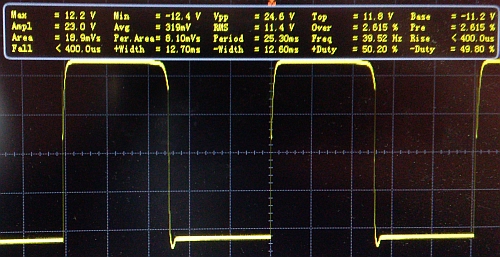

    Some time passed since our talks, but now i'm back with a working switch. I was able to put the third winding into my toroid and i let the circuit run for 6.5 hours.
    This was the 'smaller one' with the optocoupled switches from your guide (page 25, with simple analog timer based switch). The batterys are 5Ah brand new ones. I do not used a graetz + puffer in the secunder winding, instead i simply used a 6.8Ohm power resistor for load.

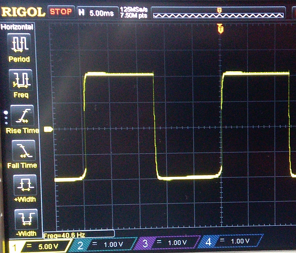

    ~40Hz was the perfect switching frequency for maximum output voltage. That's about 20Vpp (with the load attached) - 6.8Vac according to a DMM.

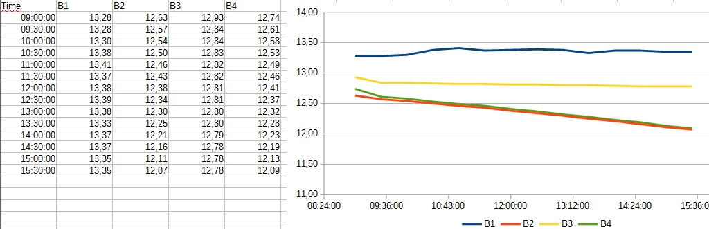

    What i experienced so far:
    The 'upper' batterys are mostly kept their voltage, while the other two are drained as you can see in the first picture.
    That draineing of the 'lower' two batterys will stops somtime?
    • Today i ran the system for 8 hours, and the upper batterys are swapped with the lowers at the start.
      The situation was similar, the upper ones are mostly kept their charge while the lower ones are drained.

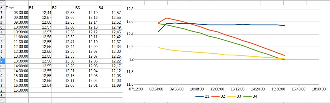

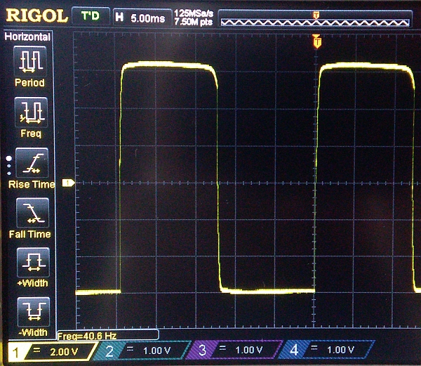

              • Now i got a bunch of new result with a 12 ohm load.
                After running my circuit for 17 hours, now i have assumptions and calculations.
                The most important is this: the lower batterys are draining constantly with around 0.07V / hour. This means the circuit are able to run theoreticaly for 2*20 hours with one battery swap. For this calculation i assumed the charged battery voltage to 12.8V (measured in working switch with the load attached), and the drained battery voltage to 11.4V (i made a complet discharge cycle in one of these 5Ah batterys to get it's end of life point). So we have ~1.4V to play with.
                In my setup, there are no rectifier attached to the secunder coil, just the load for simplifying things. So the output voltage are 7..8Vrms. This means an 0.577A rms avarage load current. This gives ~23Ah
                If i'm correct, a 5Ah battery in real life are about ~0.8*5Ah. So with 4 paralel connected battery, there are 16Ah vs 23Ah with tesla switch. This like we got a fifth battery for free.
                I'm a bit conserned about the loss of the switching transistors. They are warm even with a moderate heatshink. I will replace them with power mosfets in the future tests.
                I'm also conserned about using an ordenary graetz bridge to get the DC. I will use cheap power schottky diodes instead for lower loss. (like MBR-760)
                And i have to ask about the tuning procedure. The output voltage are perfectly constant in a range of +-20Hz, with centered on 40Hz. Is this normal? Only the shape of the square wave are degrading when moveing off from 40Hz.
                My output voltage are also somewhat lover than what i expected.
                My last question are about when to swap batterys? I see some chargeing for about 2 hours on the upper batterys after startup and every battery swap. So when to swap battery? If the lower ones are near 11.4V or when the upper ones are no longer chargeing?

                    Its been a while since I even built one of these I put in the book.
                    Which exact circuit are you running? What is the transistor part# that switches your system? What is the make of the transformer (Type, color if toroid, VA, and windings)?
                    So generally to get started I look Peak output voltage. Once I got that I look for peak current. Both are frequency adjustments. Then I try balance them
                    The other thing you have to look at and especially with the small batts is the the VA of the transformer. So to saturate the transformer you need a pulse of X size and time, Does that pulse exceed the C20 rating of the battery?
                    Maybe you have to size things up a bit.
                    If you transistors are HOT thats a lot of loss. You could figure it by the temperature to see if correlates to the drop in the battery. You might try some passive protection across the transformer. A couple of diodes.
                    Last I find the biggest losses to come from resistive loads while under AC. And you are.....
                    Try using a High speed or No time diodes for the bridge and couple that with a cap capable of running the system for at least 1 second. (Count the joules).
                    For battery swaps I like to run the $hit out of the lower batteries as long as they do not drop below 10.4 they usually are OK. I don't do that on every run but I look for the balance.
                    So what that means is for example the top battery hit 14.5 the bottom hit 11.00 and the system at that point stay stable. The difference between the 2 serial batteries is high enough that power spills over.
                    Now 2 things inhibit this and it sucks but its just fact. The transistor voltage drop, and the C20 rating of the battery + the saturation point of the transformer. You may not be able to drive those batteries into that position if anything knocking down the power point you cannot get the spill over effect.
                    Fill in the blanks on your setup for me and we'll try to get you the 8x I know you can get out of the system.

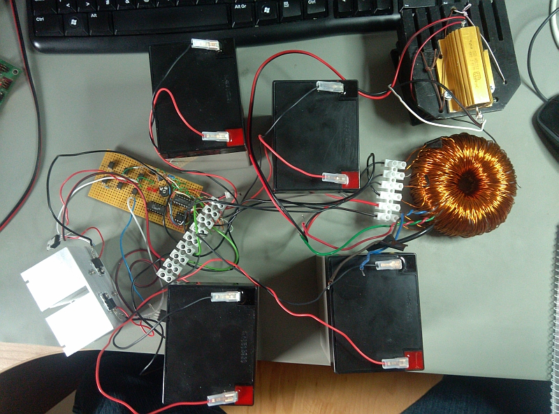

                      It's the 'smaller one' circuit on page 25 from your book, just with a simple 555 timer based pulse generator circuit.
                      For the transistors, i used MJE 15032 and 15033's http://www.onsemi.com/pub_link/Colla...MJE15032-D.PDF, they are 250V 8A power transistors. I have some spare parts of these from an amplifier building project. Your transistors in the book are MJL 21193 and 94 http://www.onsemi.com/pub_link/Colla...MJL21193-D.PDF, they are 16A power transistors with better Rthjc (and more robust case design), that can explains my heating issue.
                      I will try using protector diodes. Also, i'm still thinking of using mosfets. With the proper setup, they can have extremly small on state resistance. This may also helps with the "inhibiting facts" by lovering transistor voltage drop.
                      For the transformer, it's my hand work. See it in my previous picture: http://www.energeticforum.com/attach...016_102602-jpg I asked your transformer paramteres in late 2014 http://www.energeticforum.com/264280-post4173.html, then in this summer i finished it. It's a total of 55m AWG21 wire hooked in a not too big toroid core (about 3*4cm, maybe 100..200VA?), on top of it's exitsing wireing. This may harm it's efficency a bit, i'm not sure. Also, the wireing is a mess. Doing the wireing by hand are not an easy job.
                      I may construct an other transformer with stronger wireing, now i have a much bigger toroid core to work with.

                          So couple of things come to mind right off the bat. Just pointing them out not criticizing.
                          That transformer looks a little loose and wound heavy like that may have a little to much resistance while having a lot of induction. Depending on the material in the core you might need higher speeds but the induction and resistance in the windings will inhibit this hence 40 hz, when generally I have seen speeds ranging from 60 to 400hz which seems to work best depending on the application. Thats also with an EI core. I have not seen much luck with toroids and they are pain to wind as you probably now know. LOL
                          Even though your load is low one thing you need to look at is how much current passes on the primary windings. Input and output. So a good transformer passes 10 amp to do 5-7 amp of work on the output winding. Its never equal but should be 50% at least.
                          The transistors you are using may suit the system but I would shy away from using to much resistance on the base. Let the base catch a little current. This also may cool down the transistor overall. After all they can handle 2 amp (MAX) on the base. Not sure but you may not be opening up the junction enough. To know that though you have to push it and see its performance heat wise.
                          Also the transformer may effect the heat situation with spikes as per your induction level in the windings. Lower the amount of windings to decreases the size of the spike. Toroids don't require as much winding to couple the magnetic field. Evenly wound shorter wires perform better.
                          If the transformer is the culprit for heat mosfets won't change this. Transients are also the reason I encourage DC output to a capacitor. The transient will leave the transformer on the output line and be negated by the cap.
                          As far as the diodes go I like "No Recovery Time" Diodes which are generally Schottky but not always as they quikly move spikes away, No heat and in situation where they are over rated for the job you get no voltage drop. This is a typical one I use.
                          I would run that up to 5 amp, and at 5 amp it would drop the voltage only a small portion at 1 amp you would see no voltage drop.
                          Depending on the application and my expectation I would wind the transformer output to compensate for that drop.
