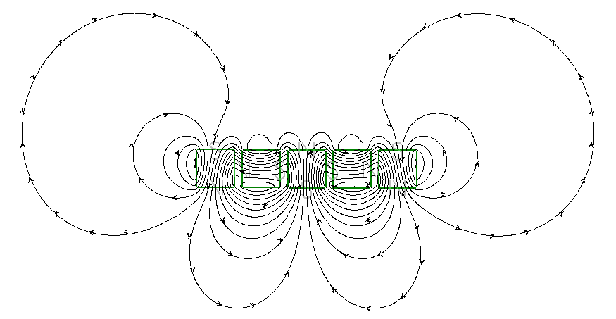

        It appears that you have cube magnets in a plastic holder that spaces them apart. I've seen these mostly for circular arrays using cube magnets.
        Halbach arrays have a strong side. It looks like you have that side facing up against the bottom of the cell. I believe that is the reason for the symmetry. All the simulations are done from a side view showing asymmetry.
        As usual, the cell has lines circling the poles whereas the femm has the lines exiting the poles.

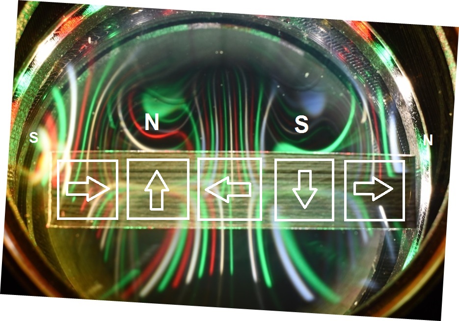

                  Hi dyetalon,
                  Can you check and verify the orientation of the magnet on the right end of the array in this photo? If possible maybe take a photo prior to covering with Fe powder showing each cube's vector.
                  Edit #2: Nevermind. I think I ran across the source. It appears there are only 4 in that array.

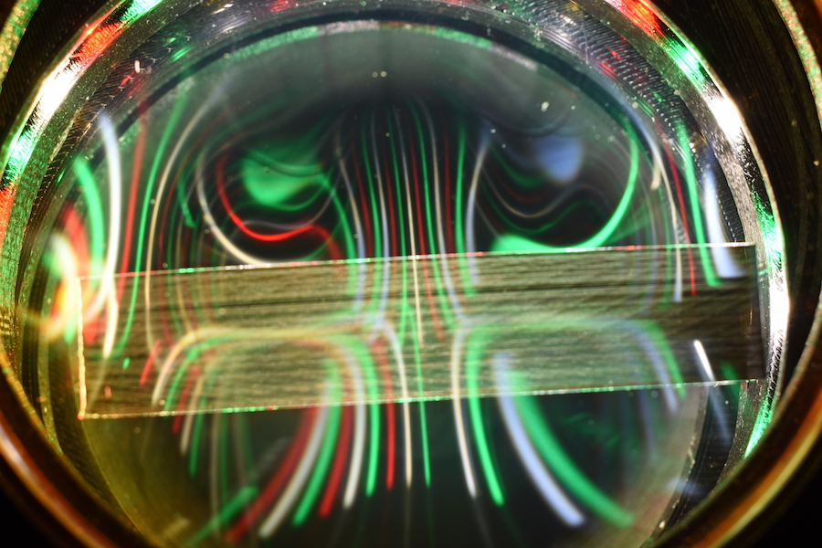

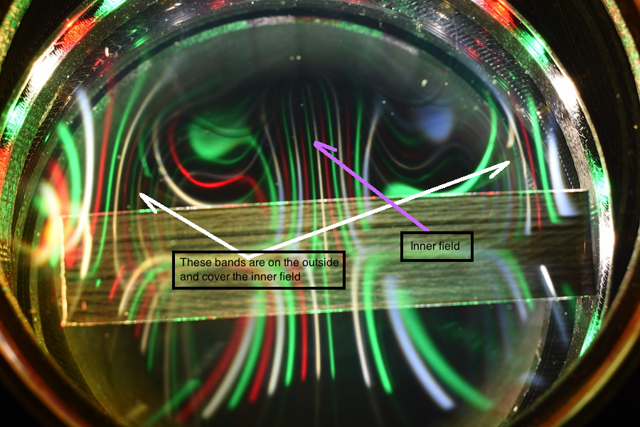

                    Any Halbach array is a complex arrangement of magnetic spins.
                    Keep that in mind when you view this image I took this morning with the same array I used in the first pix.
                    This is a side view with the two inner poles facing up.
                    Where the cell shows activity, the iron filings show nothing but space

                      That's the difference between minimum and maximum potential views!
                      I'm repeating myself here. Same thing, inverse view...
                      You don't see any detail with the filings, because the outer portion of the field is covering the inner portion.
                      And they can't resolve spatial details. Too bad all of the simulation software uses the filings view instead of the cell view.
                      But hey, a computer can't do anything more than it's programmed to.
                      The cell just 'is'.
                      to be clear:
                      Can anyone identify the strongest section of the field from the iron filings pix?
                      How about with the Ferrocell pix?
                      Pretty obvious, eh?
                      Comments please !

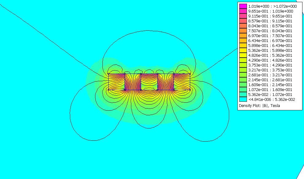

                        Hi dyetalon,
                        Modified a couple images. Will add comments in a while.
                          Hi dyetalon,

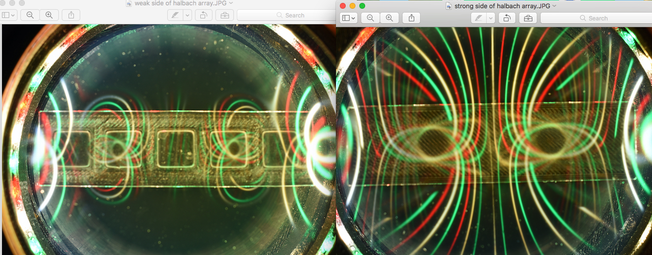

                          Before you go any further, let me apologize for not clarifying which end of my Halbach array is up and which is down. The bare magnet side is the weak surface and the plastic covered side is the more focused and powerful side.
                          The 'curls' in the above pix are the weak side where the field is folding in on itself.
                          The extended light bands are the strong side of the array.
                          Sorry for any confusion.

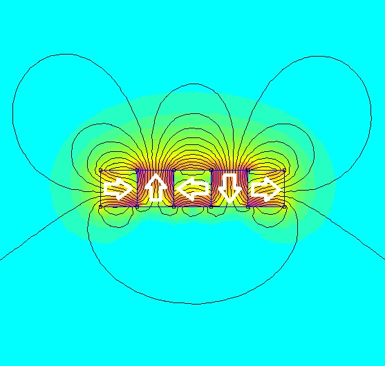

                          You need to flip the FEMM graphic 180 deg. back the way it was
                          Oh, and here is an up-dated pix comparing the array weak side and strong side:

                            Brings up a question. Using the above image, how can you tell which side of the Halbach array is stronger?I
                              Hi dyetalon,
                              The 'bands' on the bottom extend a greater distance from the magnet than the top bands do. Long bands are the stronger side.
                              When I imaged that array under the cell, it was quite obvious which side was stronger. The bands were 'coming out of the page' compared to 'curling down'.
                              Seeing it in real-life is very different than a 2-D image.
